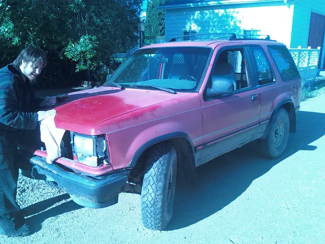

Score! I just picked up a FREE 4x4 2 door standard 91 explorer sport on kijiji the other day. Needs some work but hey, it's free, and it runs! Shifter is a bit wobbly, one tire blown out, needed a battery (Had 3 in the garage doing nothing anyway) drivers outside door handle does not work and inside pull is missing. A/C Still blows cold thou! Also front left headlight buckets screwed up and both bumpers are bent, body is in alright shape, thou the clearcoat peeled off of everywhere but the passenger side (Weird)

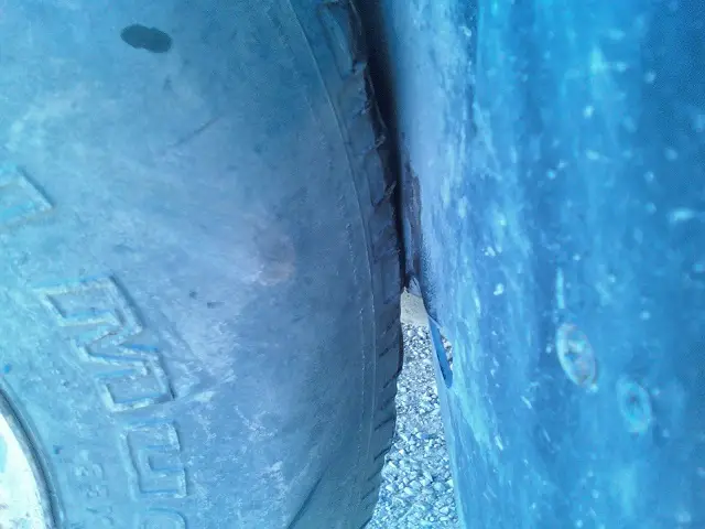

I had 2 narrow 33 inch tires beside my garage from a previous project so I figured i'd bend the bumper back to where it's supposed to be and see if it would fit. Had to mount one of them to get it home in the first place since the sploder didn't have a spare. They actually don't rub (Ok, the inner fender rubs at the rear, but it has room to move if modified with a self tapping screw and washer)

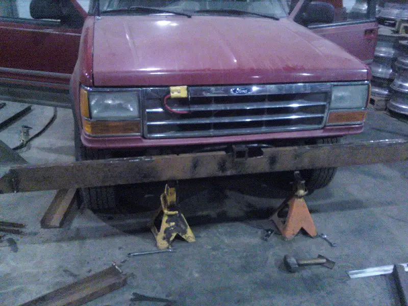

I haven't updated this in a while! For what it's worth I haven't worked on it until recently. I decided the only way I'm going to be able to do anything with this rig is if I set a low budget and have fun making it work. Since then I've gotten the lights working, regreased the front wheel bearings, repaired the sloppy shifter with some scrap plastic to act as a bushing, changed the spark plugs with some I've apparently had for the last 6 or 7 years. Most importantly I started to make a winch mount/bumper to replace the front mashed in bumper.

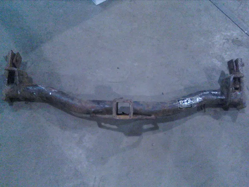

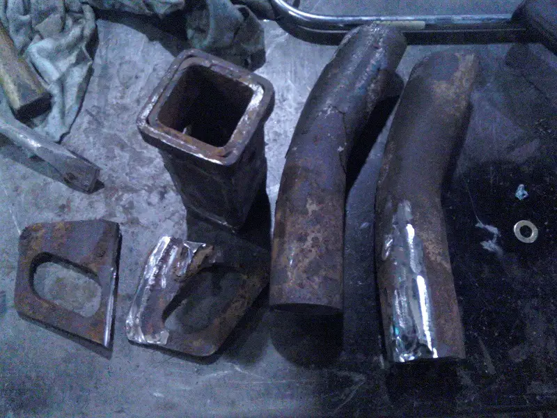

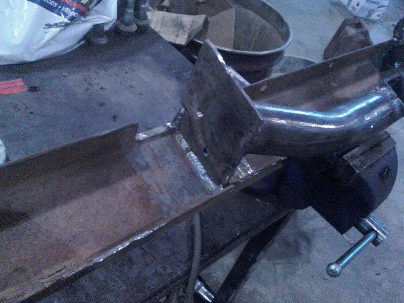

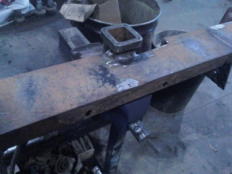

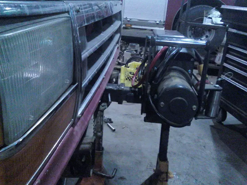

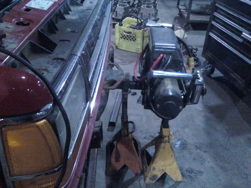

I liked how the hitch brought the receiver up from the frame rails but I didn't appreciate how it pushed the receiver outwards so I chopped it up and rewelded it together farther back. More of a pain in the ass than it was worth, considering a receiver from Princess is all of 25 bucks? This was free (Already had it) though leaving more of my budget for Rockauto :P Picture of snazzy extra wide bumper is where I left off before going home today, back at it tomorrow.

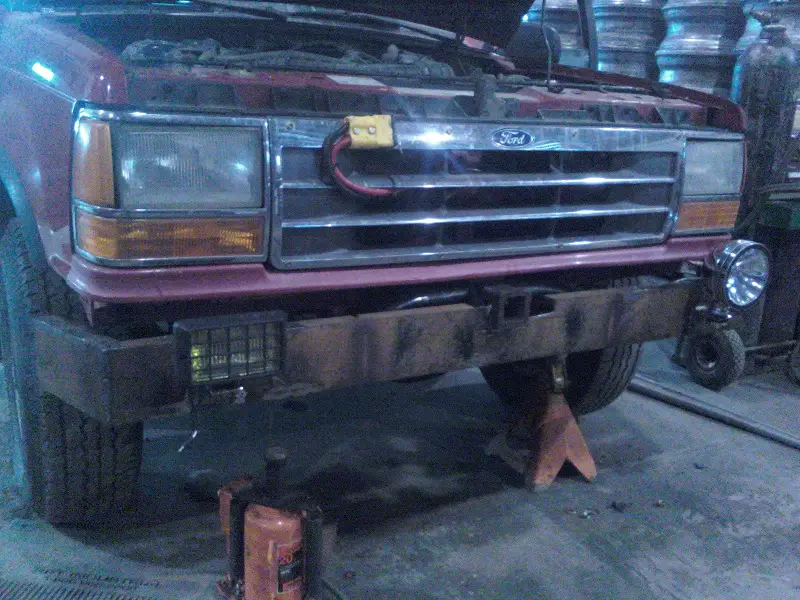

Fit and welded the channel bumper to the hitch mount today. Also welded on some tabs for the off road lights and angled the ends of the bumper to follow the fenders (A little bit) Wired in a toggle switch to a fused panel and relay for the lights but didn't have low enough gauge wire for the relay output to the lights.

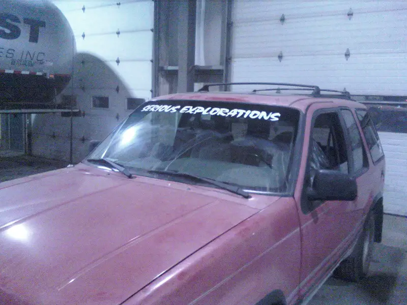

Most importantly! I finally stuck these beauties on. Surprised they still stuck after sitting rolled up in that tube for a good year or so :P

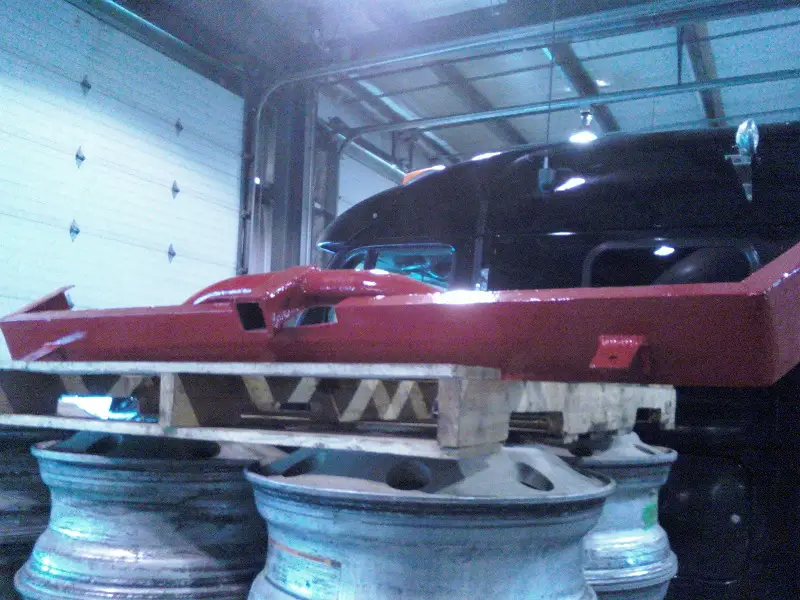

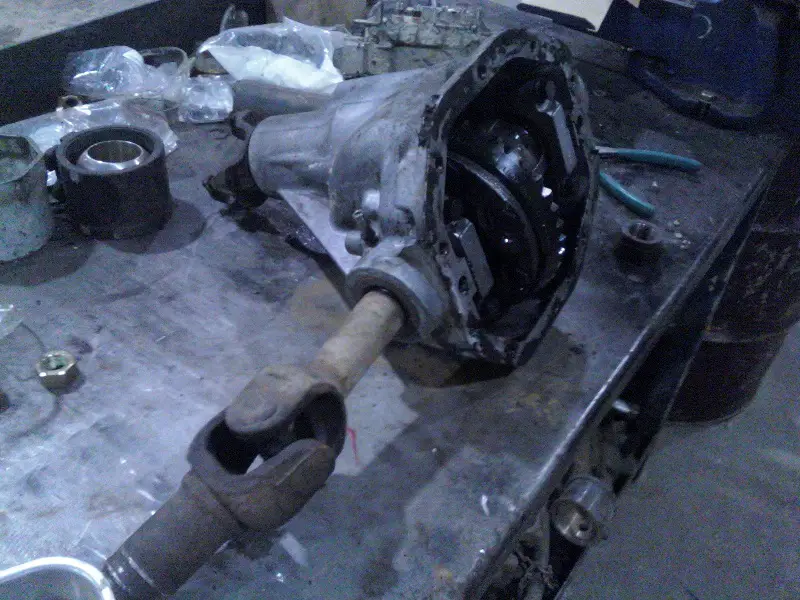

Did a few more things to the sploder. Glued the broken door pull back together, pulled the front differential in prep for welded spiders and C clip removal and braced up the bumper as well as added the D rings!
I'm interested in building a rigid A frame tow bar so I can tow the sploder to trails or rescue it with my truck. So far searching the forums and google hasn't revealed much in the way of construction materials to be used or guides to follow when making a tow bar. I've a design roughed out in my head and plan to use the D rings as an attachment point but I don't know what to use for materials. Anyone build their own tow bar for a sploder before?

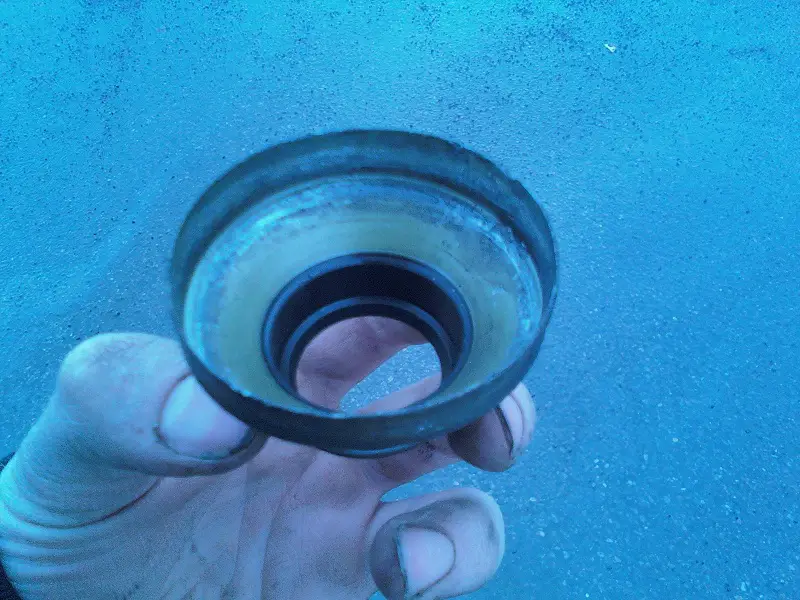

Not much new but a pic of the bumper mounted and wired. I also pulled the front diff and welded the spiders up. I intended on re installing the front diff today but the drivers diff output seal refused to cooperate. I think I may have been given a seal for the D28 TTB as the initial portion of the housing where (I think) the seal should sit is too big. I wasn't paying much attention and, thinking the seal should sit farther in the housing, I basically beat the crap out of it until it wasn't going to be usable for anything :P Somewhat related, I found (and purchased) a factory service manual on Ebay for 30 bucks shipped so my next brain fart can be corrected with guidance. I've got a Haynes already but, while excellent for the average tune up's and repairs, it's missing too many important bits.

Now that the bumper is mounted those lights seem very...vulnerable. I think a brush guard extending out past the lights is in my future
No pics today unfortunately. Got the correct seal and reinstalled the front diff and left axleshaft. While perusing the parts stores rather massive selection of automotive sprays/chemicals I found the famed can of Seafoam and lobbed it onto my pile of supplies. Back at the shop I put about half the can in the fuel tank, 1/3 in the oil and fed a bit into the intake of the sploder and I'm surprised to admit it seems to have helped. I've always been leery of putting anything in my crankcase other than oil but figured with 280000KM and being free I didn't have much to lose. The random/progressively worsening ticking disappeared completely for the duration of runtime up to operating temp with Seafoam in the oil. Hopefully it stays gone once I change to fresh oil :thumbsup: (Your results may vary :p:)
Also decided the round lights on the front bumper looked a little silly so they've been swapped for rectangular off road lights and are mounted as far back on the brackets as possible. Tested the rigidity of the bumper by lifting the truck with a highlift jack on the far corners of the bumper and the only issue I found was the bumper slid upwards once most of the weight was off the ground. Luckily I like it's higher position so I'll tighten the bolts a bit more and that's where it'll stay :D

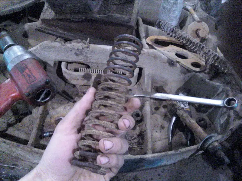

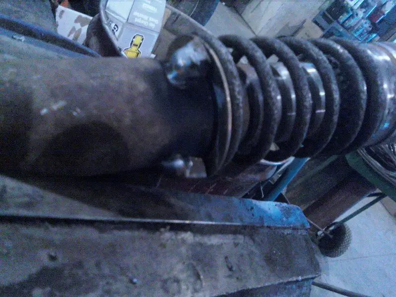

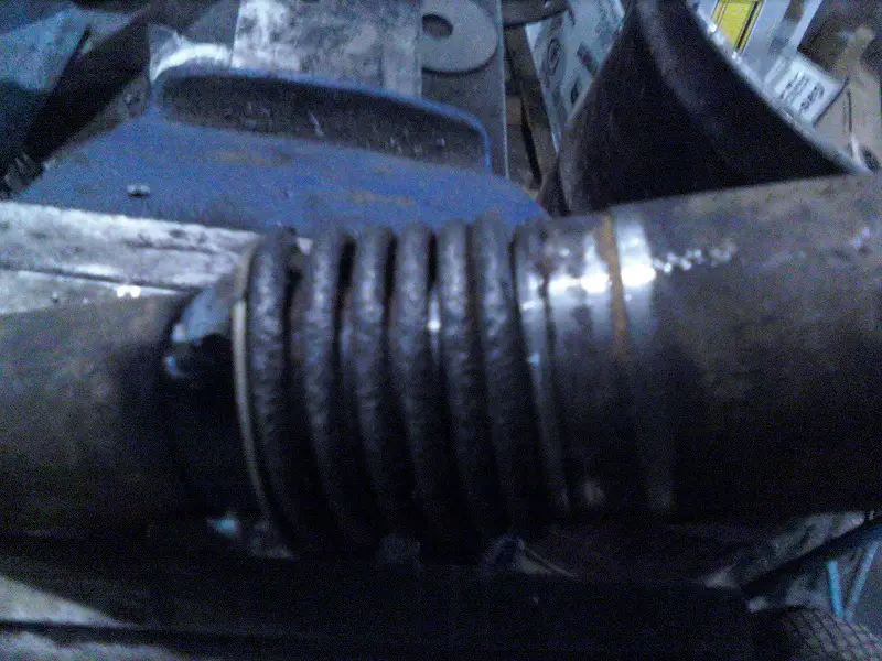

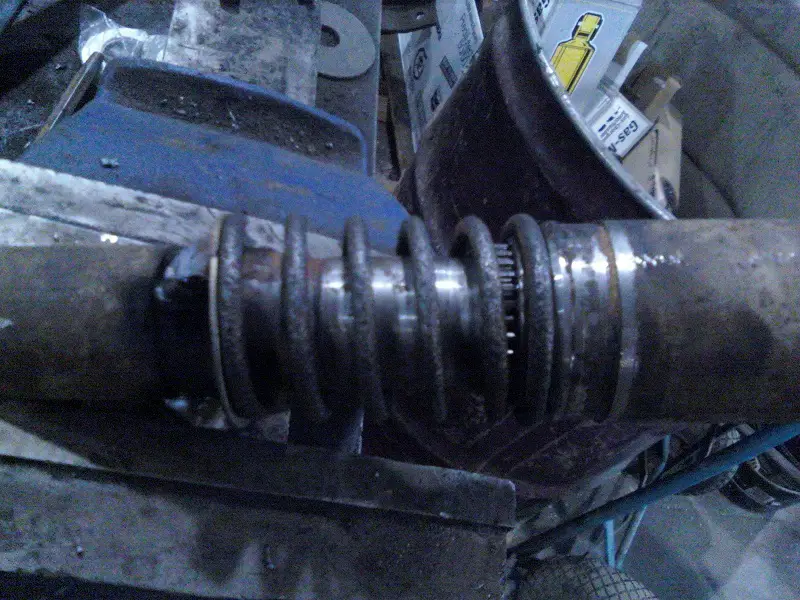

Checked what seemed like good sources for random widgets and springs but came up with nothing to use for my c clip eliminator spring on the right axleshaft. Then I stumbled across a promising spring in the shop at work. To those in the buisness of Semi truck repair you'll recognize this as a spring from a Holland fifth wheel. With the seal removed from the diff side of the shaft the spring fits perfectly over the remaining lip.
