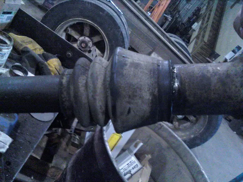

And lastly the boot fits nicely over the whole thing. Greased the splines up, pumped some grease into the boot and closed it up. Still need to add some clamps. Took it for a boot around the parking lot and now I know first hand why you shouldn't put a spool in the front diff of a daily driver. :D Not an issue with this rig thanks to the manual hubs and not needing 4x4 to get around town
Also changed the oil now that the Seafoam has been through the engine. The ticking is still present briefly when the engine is cold but goes away after a few mins. Before the engine would tick on and off all the time, now it doesn't tick at all warmed up :thumbsup:

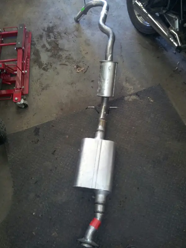

Today I replaced the exhaust from the cats back to the tailpipe as the old tail pipe had rotted out along the bottom seam. I picked up a THRUSH welded style muffler plus a short section of exhaust at the Parts Source and a tailpipe assembly from Rockauto (Along with a bunch of other stuff for other projects) and welded it all together with the MIG at home. The tailpipe required a bit of tweaking to make fit as it rubbed the heat shields where it curved over the axle. The tailpipe that came off the truck has a smaller cherrybomb looking resonator vs the bulky muffler one the new pipe came with and it didn't quite fit right.

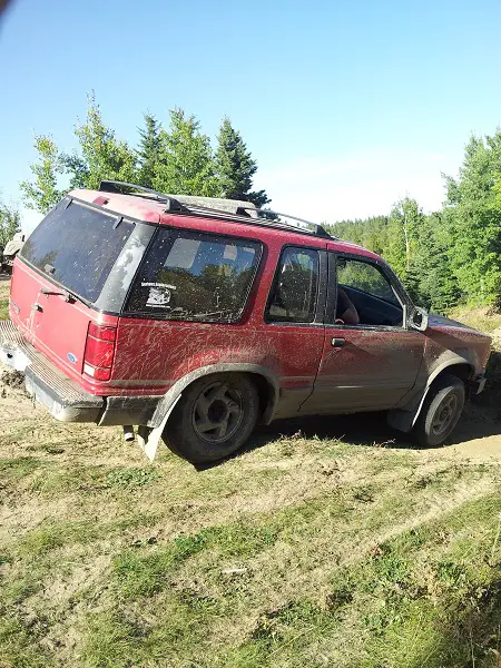

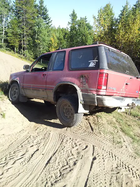

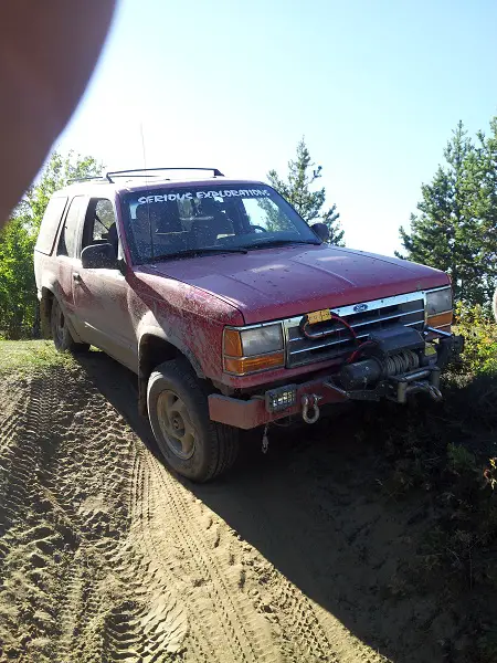

A friend came down with his new Jeep and we decided to go 4x4ing! Yes, finally a chance to test out the sploder! It preformed flawlessly with the minor exception of belching out a bunch of blue smoke for about 5 mins along the trail (Must have had a bunch of oil pool around a leaky valve seal?) It eventually stopped burning blue and worked fine the rest of the day.
Right off the hop as soon as we were offroad my friend dumped it into a big mud puddle and got stuck. I didn't grab nearly enough pics but he got it stuck enough that when I hooked up the winch he eventually came to a stop and was dragging me into the mud. I later would use the winch to pull myself out a time or two as I'm running those street tires.
Pics were taken on trails around the Caroline Alberta area

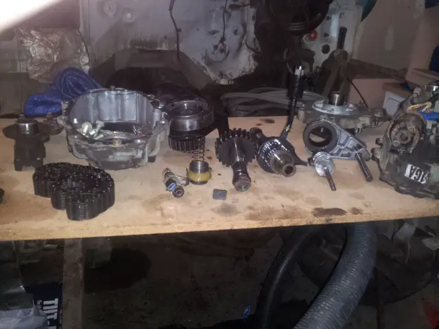

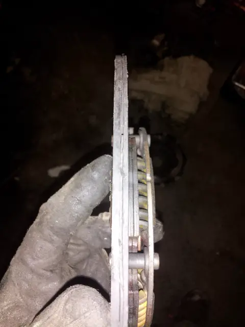

Update on the sploder. I've been daily driving it pritty much exclusively until about a week ago when the clutch started to slip. It quickly progressed from full throttle fifth gear slippage to mid throttle fourth gear slippage and the slave had been leaking for a month or two before hand so a clutch job has been a long time coming.
It might be hard to tell but the friction material on the right side is about half the thickness as on the left. it's worn down to the rivets on the thin side so it was pritty much cooked!

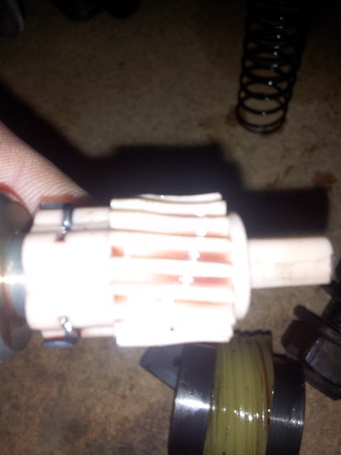

The speedo didn't work when I began so I figured I'd get that fixed while everything was apart. Both plastic speedo gears appear to be worn out, the small one is curved a bit on some teeth while the large gear is very curved and the ends of the teeth appear to be worn down. I tore the whole T Case apart to replace bearings/seals and to make sure nothing is amiss.
Many parts are already on order. The flywheel has some minor heat checking so I'm going to look into getting it resurfaced. One exhaust manifold bolt broke off at the head so I still need to get it removed and the threads pulled out of the transmission when I removed the mount bolts. Overall the removal went pritty smoothly.

Yup that was how my clutch went, with the exception I gave up when it wouldn't pull a mild hill in 2nd gear..... the disc was down to the rivets on both sides (didn't get pics) but it was entertaining to look at, and thinking no wonder I couldn't go up a hill!! :D
I didn't want the headache of trying to shuffle my abundant junk vehicles around with one that wouldn't move under it's own power, otherwise I'd probably have done the same thing just to see how far It would go. Impressive that it wore down to the rivets on both sides; this clutch had only worn the radial groove from the thick side. I suppose once you really start to slip it wears pritty quickly from there :D
Yeah once I noticed the slipping it wasn't more than about 3 months before I gave up on the clutch. Might've got 3k miles extra after slip detected. Either way I changed the clutch at 200k miles, and the clutch was factory.... not bad.

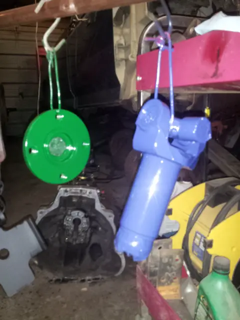

Waiting on parts, installed some new ujoints and paint

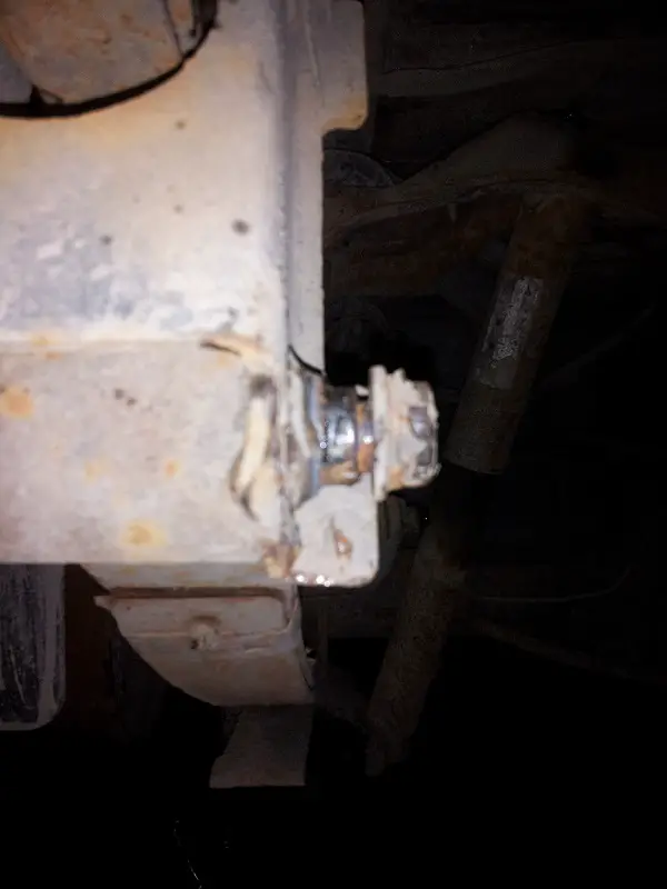

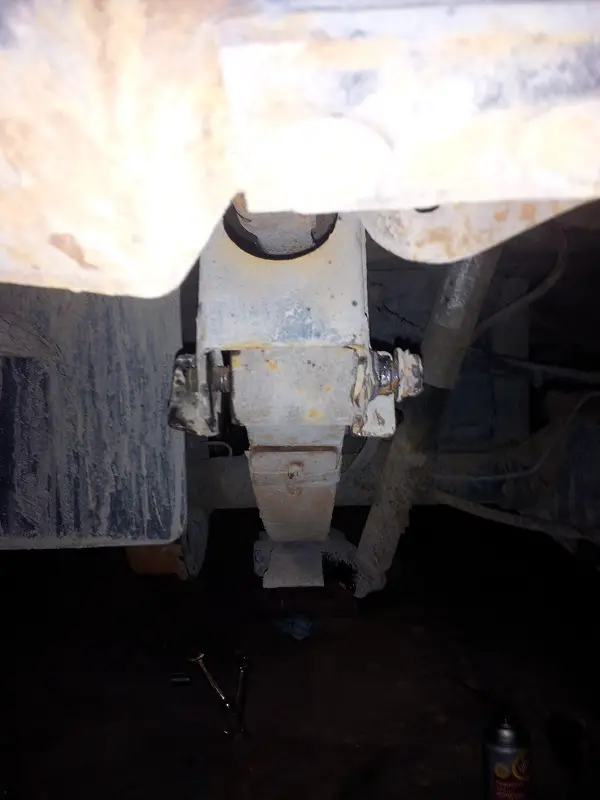

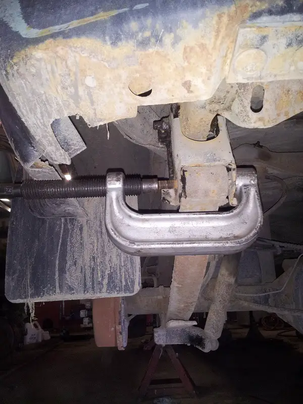

Quick update. Still waiting on some oddball parts to finish my clutch replacement so I figured I'd start installing the four inch Rough Country lift I picked up :3 I decided I'd show off a neat trick I've used to remove bolts from stuff like shackles in the past when the bolt seizes to the inner bushing sleeve. To get the ball joint/U-joint press open end over the bolt head I had to remove the tab that prevents the bolt from rotating while tightening the nut. I just broke it off with a chisel and hammer
Then press away! Wait, something's not going right here...
So now I'm pritty sure this trick won't work very often considering how rusted first gen explorer shackles usually are. These two are in top notch shape considering they lived well past 280000km in central Alberta with naught but light surface rusting. The sleeve held on so tightly to the bolt that the press simply pushed the sleeve clean through the shackle! Sadness. Luckily I have warrior shackles on the way so I didn't need to reuse these and the top bolt on this side tapped out very easily. The press is too long to fit up near the top shackle mount bolt and the tank is probably in the way to do the left front, this trick might not be very useful on explorers at all! I used it with great success on my F250 however and It's a neat way to use a balljoint/ujoint press if you have one. With enough room you could probably use it to remove stuck lower rear shock mount bolts as well but after that carnage I'd be careful not to wreck the shock mount in the same fashion XD

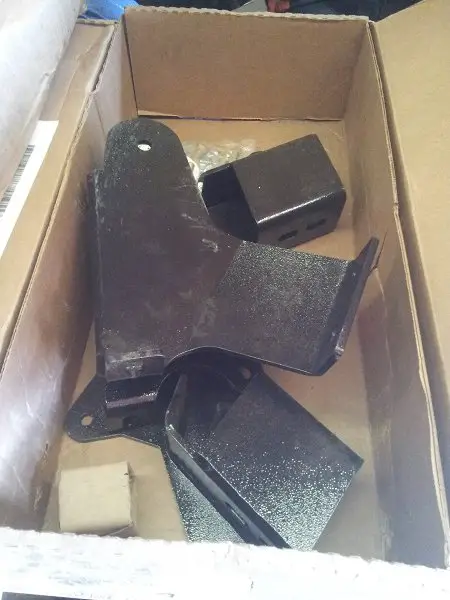

Sexy parts pics! Everything looks good so far though I am missing a part. The passenger side ttb mount drop bracket is MIA. Luckily it was noticed when I was picking the parts up and the shop I bought the kit through got a hold of Rough Country who apologized for the missing part and expedited one here, should be here Monday. Good service!

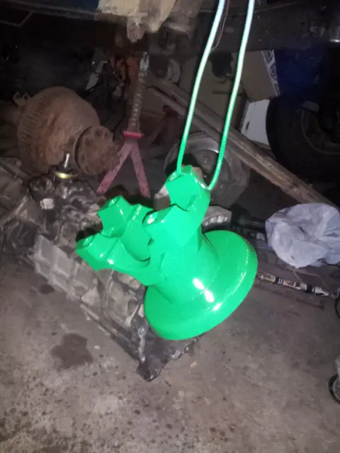

And a random sexy driveshaft picture
