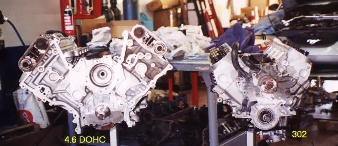

You can't do it. You can but you will have no accessories or inner fenders. The '96+ use a 4.6L V8 The Explorer still used a 302. A 302 is a tight fit in a frist gen. You pretty much have to have a body lift in order to fit it too. Enclosed is a pic of a 302 and a 4.6 DOHC.
