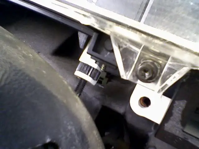

This is optional as you can adjust if you have small girly hand's...but i dont. remove the 9/32's bolts 4 they are he one that go directly to the housing.pull housing(carefuly all the wires and cable's are still hooked up) a inch forwad. Use that screw driver to wedge under neath it will look like this.
Ok do you see that white gear, with a small black gear in the center...?there is a small treaded PLASTIC(be careful) rod that screws in to it(from bottom).turn the black gear clock wise to adjust the lever forward.Counter clockwise to back it up.Do not loosen to much it will come out then your stuck pushing the thread up and keeping the white gear straight while turning the b;aclgear.When you happy put the dash faceback on in the opposite of paragraph one.

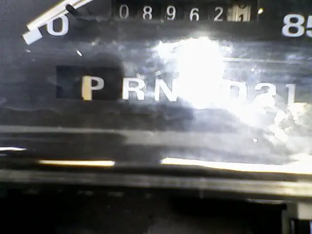

final product is...
