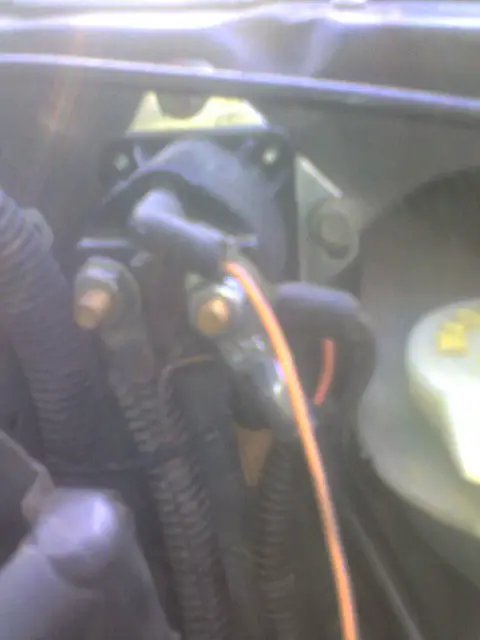

Basically, you'll touch both posts on the starter solenoid with a screwdriver- one that has the wire running to the starter, and the one that runs to the battery. You're turning the screwdriver into the switch.
Someone in the truck, in neutral, clutch in. Key turned to on, and you touch the solenoid terminals with the screwdriver.
This thing:
Clear as mud? :)
