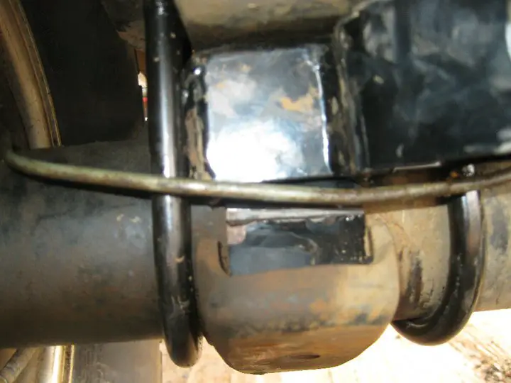

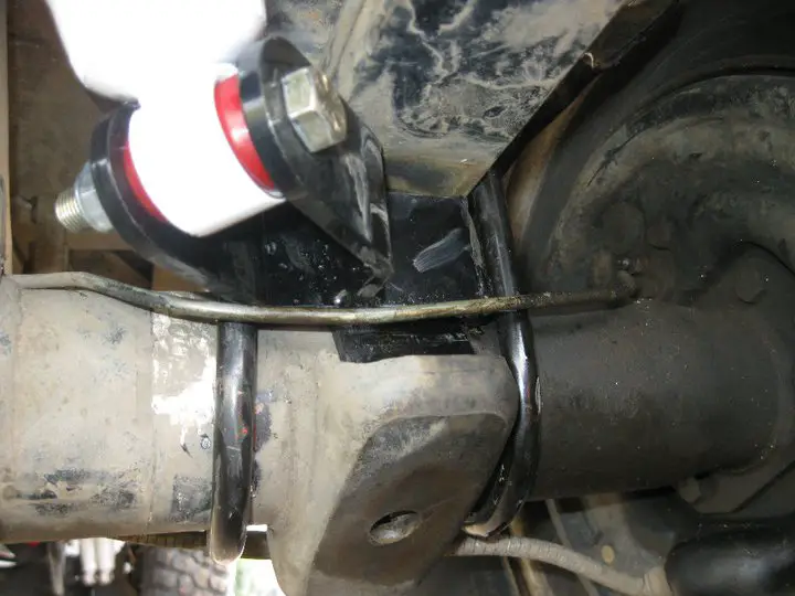

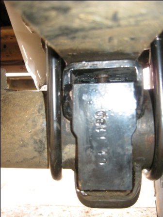

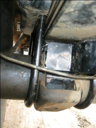

Broken Axle Flip Brackets
So here are some pics. They aren't the best, its kinda hard to tell, but if you look close you can see the fractures that occurred on the rear side of the brackets.

here's one for good measure...

Well I got on the horn today. New axle flip brackets are in the mail. 1" coil spacers should arrive tomorrow. I also got the 6-8" pitman arm (FA600) coming in the mail as well. As mentioned previously, the new extended driveline is also currently in the shop, we should have everything by the middle of next week.
Oddly enough, the manufacturer (Superlift) has had a few of the axle flip brackets fail at the welds before. They didn't have a lot of explanation as to why. They do have what they call a limited lifetime warrenty on their parts....not sure what that means. Needless to say, we're not feeling the most confident in their product at the moment, but since it's free....we'll give it another shot.

If I were you, I'd be welding those spring perches to the axle.
Yeah, that's what we're planning to do, don't want to take any more chances. Obviously, the brackets are meant to work so you don't have to weld them on...but we don't really have anything to lose from welding, I'd rather sell the rig before I ever take this lift set up off.
wait wait...they weren't welded on in the first place? :roll:
maybe I'm all wet here....I thought the Superlift axle flip brackets or "spring perches" were designed so you didn't have to weld them onto the axle? The install instructions said nothing about it, and when speaking to the manufactuers and the distributer (they also install the lifts themselves) they said welding wasn't required.
Now that I think about it though, I do recall reading from some others on the forum that they did do some welding with this system to make sure, and avoid this same issue I faced.

First, make damn sure you check the welds when you get the axle flip rear leaf spring perches from Superlift. I'm not sure who else makes them, but I'd advise going elsewhere.
I'm sure others have had better luck...but something as important as the integrity of the welding on parts holding the rear end together should not be left up to chance.
The first pair we got looked correct, but failed almost instantly at the welds. The second pair we got had one with shoddy tac welds that was shaped right, and one that was welded correctly but was mishapen, and simply wasn't going to work. When we got the replacement for the misfit part, it came with the same weak tac welds as the other, and wasn't welded on straight.....U GOT TO BE KIDDING ME. We finally just said screw it and took matters into our own hands, broke apart the bent one, re-welded it, and welded up the other we had on hand to be up to snuff. Then we welded both to the axle to make sure they didn't go anywhere.
