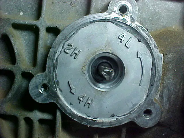

I would like to start out with apologizing for the I'm sure repeatedthread. I'm new to the forum and just don't have the time to search all the post to find the cause of my problem. When I press the 4 High button the light led comes on, the instrument cluster indicator light comes on, and I can hear the relay click in the rear of the truck. Unfortunately there is nothing happening in the transfer case. This is only happening with the 4 High. 4 low is working like a champ. I have rebuilt the LF hub because of a bad bearing. Has anybody encountered this before? What was the fix.
