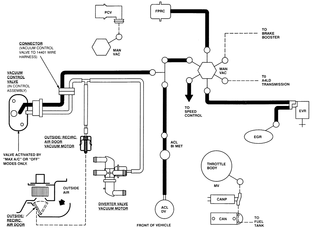

1994 Explorer Vacuum hose routing
yes sir,, i have flip flopped my iac bac and forth from the new one back to the stock one after i took it apart and cleaned it out good.. and disco'd the battery each time,,let it sit for about an hour with the dome light on,,to drain everything i guess,, than after i reconnect the battery,, i start it and let it sit and idle for 10 mins,, than i put my foot on the brake,put it and drive and let it sit idleing in drive for approx 10 mins,, than i always drive it at least 20 miles,, and it always seems to run great,,

awesome !!!!!! a vacuum diagram !!!!! i really really appreciate that !!!!!! you are the man!!!
