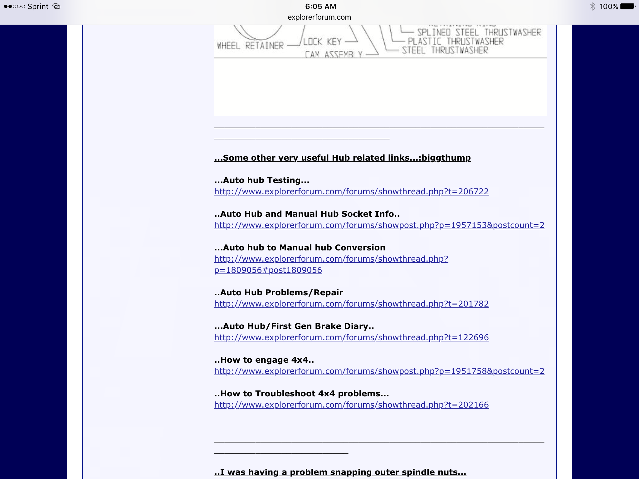

Haven't ever heard of that. Here the link to all info on hubs Your Stock Auto/Manual hub info - Ranger / 91-94 X
It contains these links which may help you.
