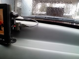

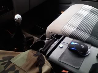

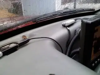

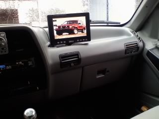

5) Some of the tech folk will like this one...I have built and installed an complete PC and screen on the cheap.
a) D201GLY2A Intel Motherboard and CPU ITX board combo $70.00
b) 1gb of Ram DDR2 667 speed Centon Brand Ram from Wal-Mart $30.00
c) 7" LCD VGA Screen (It had TV...but I removed that feature cuz it was analog it has RCA in also but I wanted the VGA for best PC resolutions) From DealExtreme.com for $70.00
d) External DVD Burner. I converted from a laptop drive as a DIY kit $40 for drive Newegg.com, and the external housing from MobileComputingSolutions.com for $14.00 Total plus s/h was $56.50.(I give this price but I did not buy a burner...I salvaged one from an old laptop given to me from a good friend who fried it and some stuff in it was still good)
e) 160 GB EIDE Western Digital caviar Blue laptop hard drive and a converter to 3.5 pin standard drive cable adapter and single drive round cable. from Newegg.com about $65.00.
f) 160 watt 12 volt to PC power (WIDE RANGE 6 to 26 volt input) supply with battery sensing from e-bay for $40.00. (keeps me from fooling with Power bricks and converters and inverters and such...plus it provides a clean power signal for the PC.
g) Microsoft streets and strips with voice and USB / GPS Receiver from amazon.com for $14 bucks.
h) D-Link USB WIFI G Dongle...$20 I don't remember cuz I have had this for a few years. (Works great in the parking lot of malls and McDonalds and such...also at home for when I need updates or other stuff)
I) Blue Tooth Dongle with 100 meter range. From Deal Extreme $3.00.
j) Aluminum plate to mount the MOBO on...scrounged it. Free
k) Other software was from source-forge.net, C-Net.com and open org. and such.
L) Small sized mouse and keyboard(laptop size)...and touch screen panel for DIY touch screen monitor all from Deal Extreme.com. Touch panel was $37.00, keyboard and mouse was $25.00
m) 4 port 5 volt powerd USB hub. $12.00 from New Egg.com
n) The needed wiring harness to PC, and 4 port Hub, adapters, connectors, solder, plugs, and wiring I had on hand so I estimate the cost to 20.00. estimated labor time of 40 hours to learn and plan, then build and install. *note: I have strong knowledge of electronics, PC building, software installation, drivers firmware, and such. (PLZ research this completely so as to prevent un-needed electrical hazards)
o) I put my install so I can remove the screen at will, and all plug ins are usb for the same reason...this is not a BLING truck...I am the spartan type. I want function / utility, neat / clean.
p) Grand total for this project $462.00 over a 2 year time span. Not a lot of money over time. The Motherboard is where the Glove box was, and most wiring is hidden. DVD is on dash when I need it to be, same with all else...mouse is on center console. GPS and Wireless G is on dash...I get great reception for both. EZ and cheap if I had to do it again...and there are many how to's on the net. Pics to follow soon.
