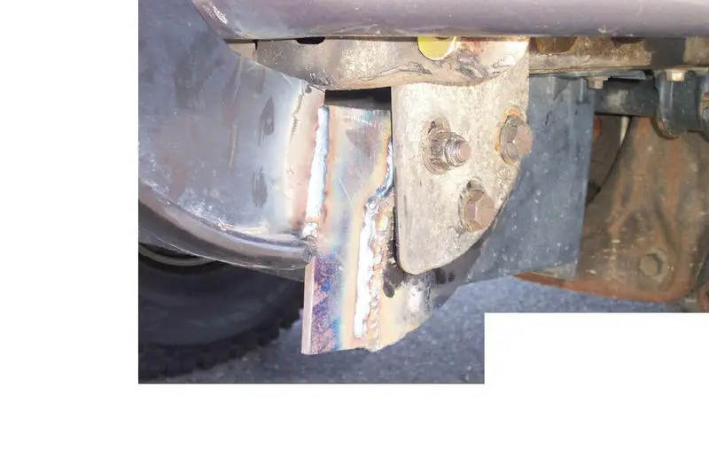

How would this thing work with a 2" body lift? Ive always been thinking of just fabbing up my own bracket that would run from the frame, follow the countours of my brush guard, and mount it where ever i decide. Id be worried about buying a $450 sturdy mount and having to do this to it:
