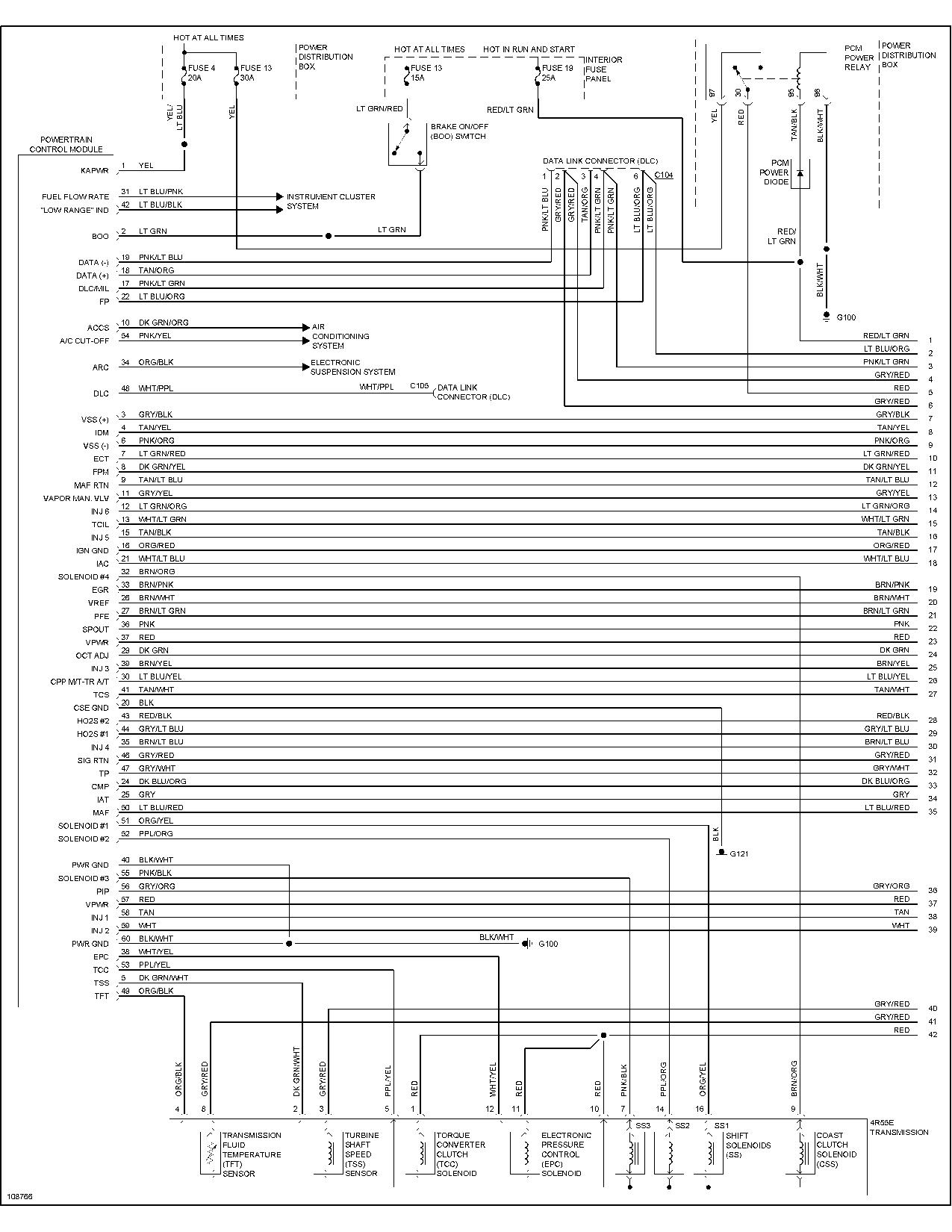

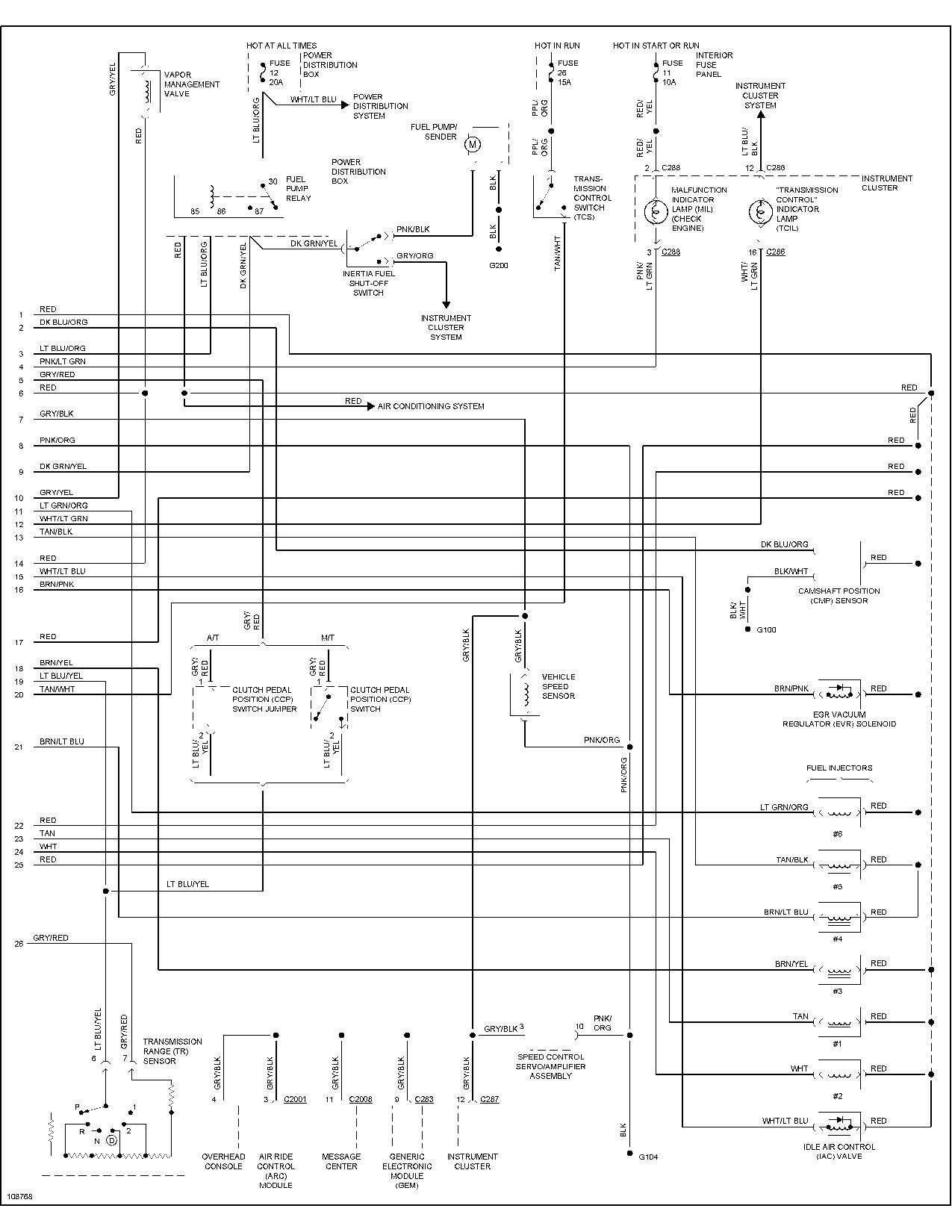

After every 10-13 attempts it starts... A mechanic checked spark plugs, cables- they are fine. Also, fuse and relays were checked and it is working fine. He said today he will look at the fuel injectors and maybe computer isn't getting signal that is why can't start. He said he needs a diagram of the injectors and fuse, does anyone has it?
You more than likely will have to buy an alldatadiy membership for your specific engine of your explorer, that way you can
Not only do some of the testing yourself, but have all the diagrams, etc on hand, and sometime you can find a discount code to reduce the price too
If it helps, here are the engine control wiring diagrams. If you print them out they lay side by side.

thanks for the diagram, it is very difficult for me to understand it though.
