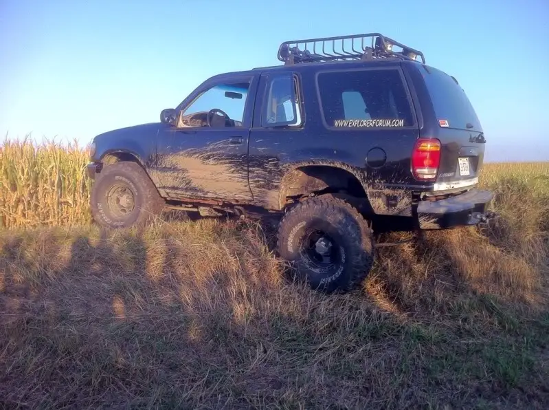

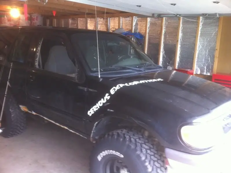

i have a 96 with a 4 inch Superlift kit, tt equivalent and shackles,
when i did the lift i did gears at the same time, it was a package deal,
i have about 6 inches of lift both ends, and for 35's i had to cut a bunch in the front,,
i ended up cutting twice as much as in this picture to make them work,,
you must regear for 35's
it's not hard on the 4x4 as much as it's a transmission killer if you don't,
and a transmission is worth more then a 95 Explorer is,,

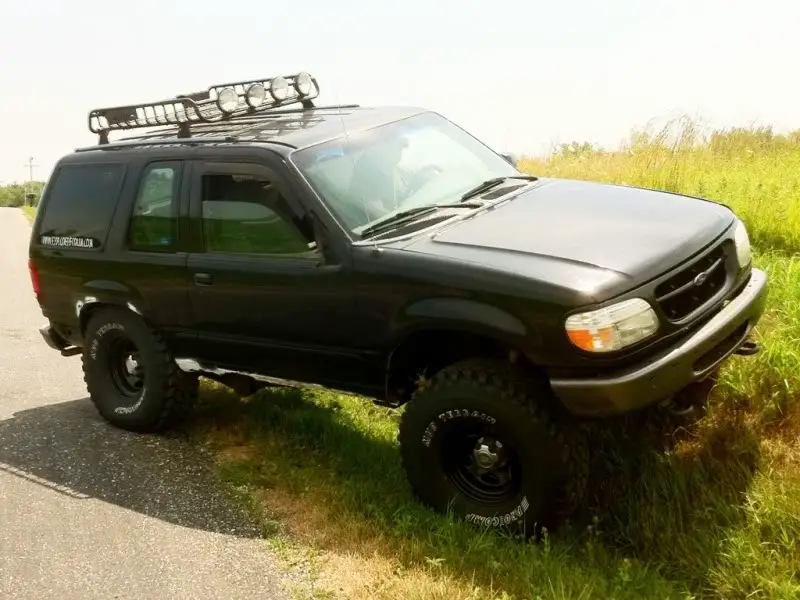

heres mine on 35's after a day at hollister...
