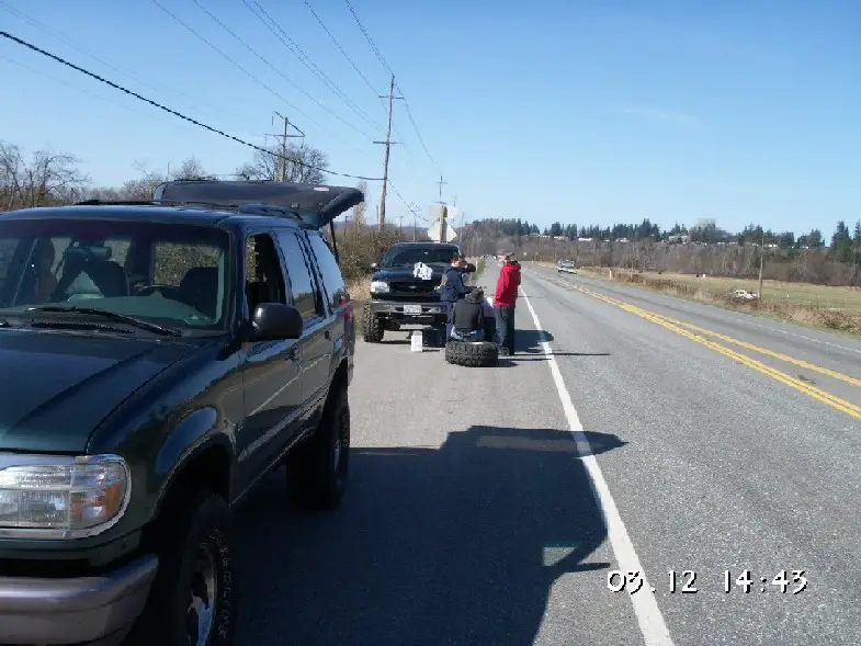

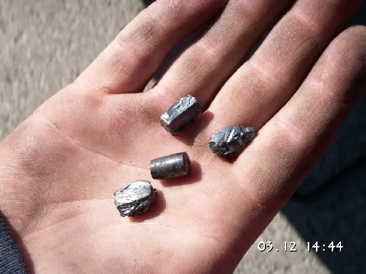

Anyways, the answer to your first question is the hub assembly. Its failing. Fix it immeadiatly or you will be stranded on the side of the road like this. Those little metal things are the bearings.

Nope, didn't expect that. And I don't entirely know what it means either. :D
