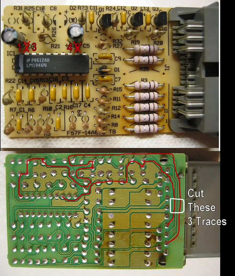

If your LOM board is not the same as I've pictured and at the following link, then I have wasted a little of my time (but not too much, when you get a look at the pic below you'll realize I did this quick 'n dirty), but the same general principle would apply:
Ford Explorer LOM Module
This board is based on an LM1946N 5 channel comparator chip. Datasheet: National Semiconductor - datasheet pdf
It is using 3 of the 5 channels, 1, 3, and 4. On the picture below I've done a rough trace of 2 of the 3 outputs sent to the console display unit just to help anyone follow along. This chip measures a voltage drop across the big resistors seen on the right side of the picture below and if the drop is too small it outputs a signal. If you merely cut the signal lines then it can't signal the bulb circuit is using too little current (bulb out or in this case is lower power LED bulb(s)).
The bottom half of the picture below is a mirror image and rotated 180' so it corresponds to the correctly oriented top half of the picture, making it easier to trace. You can see on the picture where the 3 channels used, trace over to the connector pins. You should be able to just cut those 3 traces to deactivate the warning.
The more tedious method of trying to keep it working would be based on mathematically arriving at altered resistor values and making out a complete schematic of the board. The simplest first attempt would be measure your original bulb current, measure your LED bulb current, and divide original by LED. Suppose the product of that division is 10, meaning the LED bulb uses 1/10th the current. You would then measure (or read from the color stripes) the resistance of the respective sense resistor (row of the 7 largest in the pic, most channels have two resistors in series) for that bulb, multiply that by the product above (10) to get the new resistor value you need to put in, in place of the originals... or plug more numbers into the datasheet equations to alter the other resistor values which would gain a little efficiency. It "might" not be that simple, adjusting the current sense resistors might also require adjusting the others, so it's easier to just cut the traces if you just want the warning to go away.
If your LOM board looks different, it is still likely to be based on a similar principle where it measures voltage drop across resistors and outputs a signal on thin traces (since the bulb input and output current have to use thicker traces) so you'd cut those thin traces. No guarantees there, with a different board layout unless you trace the circuit (since I can't see it).
If you later want it working with stock incan bulbs again (working meaning indicating if they burn out, they will still work to make light either way), you'd just take some wire and solder it between the first two solder points on both ends of where you cut the traces.
While we're looking at it anyway, those big sense resistors' solder joints are a common failure point on this module. If yours fails you might want to try resoldering them.
