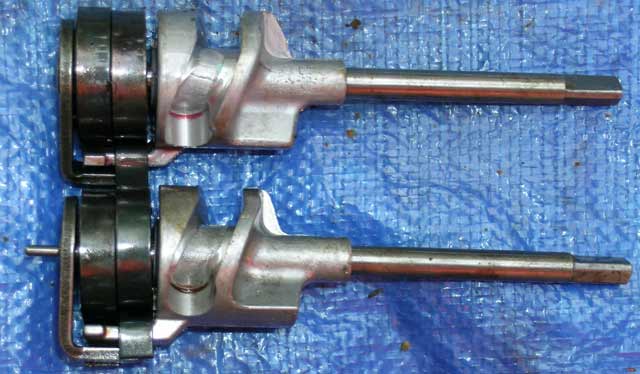

Sorry I forgot to mention, you can not open the transfer case while its on the vehicle as it would be impossible to reassemble in that position. You have to remove it and rotate it 90 degrees (with the rear output flange facing up) to pull open the rear case half. And you have to be careful because the shift rail's pin is very tiny (only a few millimeters in diameter and therefore is easily snapped) -- see picture below.
