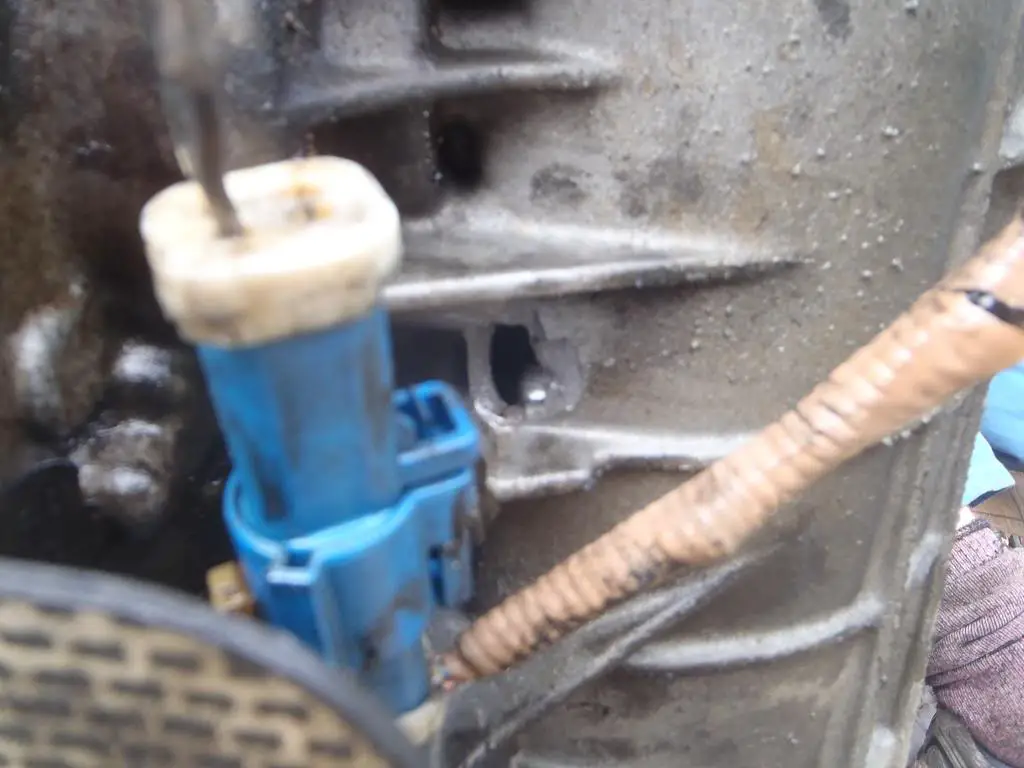

In case anyone's interested in why it was leaking fluid and had no reverse.
Anyone ever seen the like?
Yes I have seen holes is the cases before, obviously something with reverse has broken and wants out!
I'm no stranger to claustrophobic conrods but I've never seen a transmission part go on a tour.
Then I wouldn't have seen anywhere near as many transmissions as you have.
