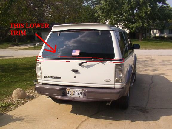

I think it would look better if i painted this lower trim on the hatch of my truck white. I was wondering if it can be removed, if so how?

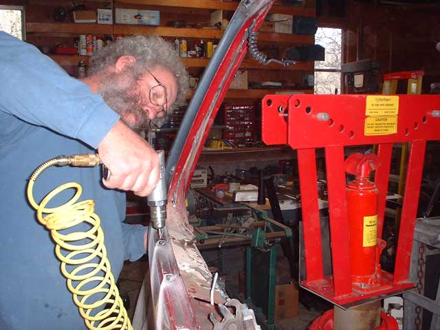

I just took mine off a few days ago. There are 7 rivets under the window weather stripping. I just drilled the heads off and popped the rivets out..
Here is a pic... :D

does it look goofy if i only take the bottom trim (the one i pointed out) and not the top (near 3rd brake light)?
Yea sorta... although your lund spoiler covers it quite good. I would wait with what Section has in store for us. :)
