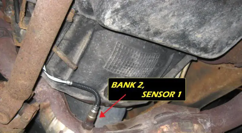

I was takiing the console out to get to bank 1 sensor 1, been having a slow response code thrown for about the last 1 1/2 yrs., also just noticed that im starting to get the same for bank 2 sensor 1. THe truck has about 160K. It time for inspection so i need to get this fixed. Truck has been running great since all the work i put into it last feb, getting about 16mpgs.
Anyway, my issue is that there is absolutly no way to get the 02 sensor socket on the sensor (bank 1 sensor 1) without either removing the lower trans line(at the trans, which would be a miracle also, also would have to bend or remove the trans fill tube), or i would have to drop the exhaust on passenger side. I have two different 02 sensor sockets, one tall, one is not, cant get either one on.
Is this something you guys run into when changing this sensor?
