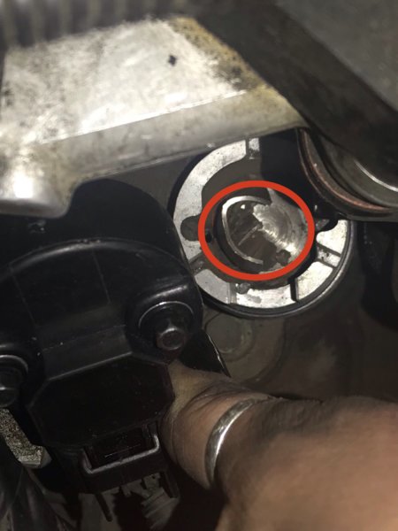

I'm trying to replace the cam sensor but it's not fitting on correctly. This is what it looks like.
Look's like you need a new cam synchronizer.The middle part spin's, and yours looks bent.
