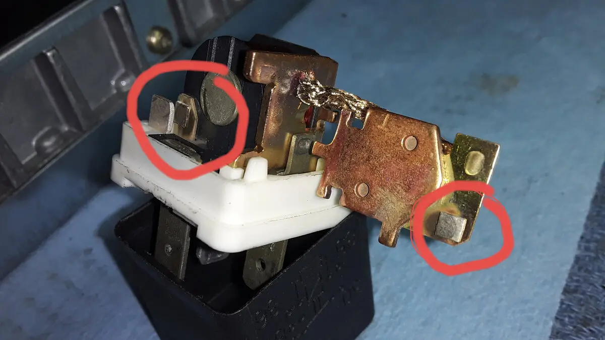

Take a look at your pcm relay

Those are good possibilities. My last 98 also stops briefly on occasion, I've figured it was a bad connection, the relay is a wise thought too, to replace. Thanks @donalds.
