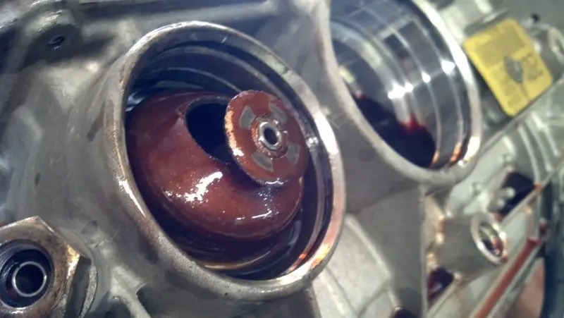

Your only hope on a quick fix is if the band is not broke but the servo that applies it is, this will give you the same problem you are describing.
If the OD band adjustment bolt turns in more than 3 turns the band is broke.
The servo can be replaced in the vehicle but if the band is truly broke the only thing you can do is to pull the transmission and repair it or replace it.

I've been adjusting the Intermediate Band to 2.5 turns out, and the OD band to 2 turns out. You have both adjusted to 2 turns out. Which is correct?
That picture is a clip of a picture I found online that showed the location of the band adjustment bolts, it's a late model 5R55W transmission but the concept was the same as the 5R55E so that is why it shows 2 turns.
There is info out there to adjust the Intermediate band back to 2.5 turns for the years of 95-98, so that's probably where you got that.
From the first C3 transmission that was installed in a Pinto in the mid 70s to today's 5R55 they have used the same band. We have set all those and everything in between to 2 turns out regardless of year model without issues.
