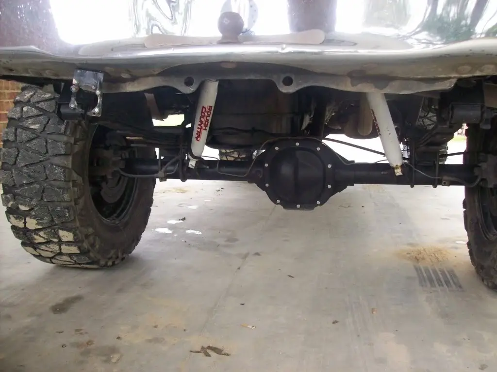

Hey all. this is my x that i recently about got finished up. Took 2 months working on it every other sat. I still waiting for my sway bar endlinks, hi steer arm, and tre,s to come in to re do steering. But i will include pics as well as info.
Front end
78 F250 HPd44
stock shafts for now
4.88 liberty gears
tru trak posi unit
mile marker hubs
ranger steering box
1.5 OD .250 wall dom
79 outters
reid racing hi steer knuckle 4 stud
OEM 5 leaf waggy springs
rustys offroad break lines
rustys offroad shackles
blue torch fab weld together shock hoops
bilstien 5125 14" travle shocks
Rear
93 8.8 f150 rear
eaton carbon fiber posi unit
liberty 4.88
youkon chromoloy shafts
stock explorer rear disc
re drilled rotors
some cheasy i think rough country shocks
truck is a eddie baurer 2 owner mint 4.o. Has every option. I still have to do my t case swap so i can get a front shaft but here are some pics. i will get some action pics soon. it flexes better than my xj with long arms.

why a transfer case swap?
to get the right yoke setup for the drive shaft?

nice truck
how does it steer?
why didnt you go high steer? you have a fancy knuckle with a flat top for high steer, but you decided to bend the tie rod and put it under the leafs.
just asking - not dissing your setup

to answer a few questions.
I do have complete high steer now. 2 REID knuckles and sky manf arms. I no longer have the himes. I am using 1 ton chevy tres. I have a 99 2wd superduty pitman arm 8in long for full steering and better ratio. I also am in the proscess of making a removable quick disconect trac bar. i am using jks jeep ccherokee quick disconect sway bar end links. I will get pics of. its great now tho. Can go down interstate all day running 80 with a jeep on a trailer behind it. tows better than before, better mpg, better power, better ride, less steering wondering. I love it
The t case swap yes is for the drive shaft unless someone knows how to put a flange on this one. I do believe i have a 31.5 spring perch width. Been a whyle since we did it.
wadetoombs87
January 22, 2011
34
Prince George VA
99 4.0 Eddie Baurer
It is doing fine. I have to put bump stops in up front and a driveshaft still. Other than that I got about 4500 on swap and its doing great

Can you post a pic of your front rear spring mount setup? Also any updated pics of the trac bar setup and high steer and Tre's?
Also, one other thing, the rear 8.8, are those F-150 rear springs or Ex springs?
And you say OEM 5 leaf waggy springs, do you mean oem Jeep Wagoneer and if so what yr and I am assuming rear springs to a moderen wagoneer instead of a older 70's front springs due to the fact you mentioned 5 leafs pper pack and I think the front 70's units had like 7 or 8 leaf front packs.

so is the front an 8 lug and the rear a 5 lug? nice swap btw
