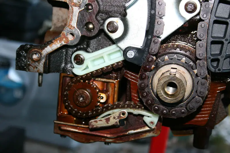

Balance shaft chain tensioner?
The 4WD SOHC V6 usually has a balance shaft. The balance shaft chain tensioner is located at the lower front of the engine on the passenger side.
It is visible after removing the front cover but the block cradle (upper oil pan) must be removed in order to access the tensioner vertical mounting bolts.
I suggest removing the serpentine belt and run the engine for a minute or two. The noise could be coming from the belt tensioner.
