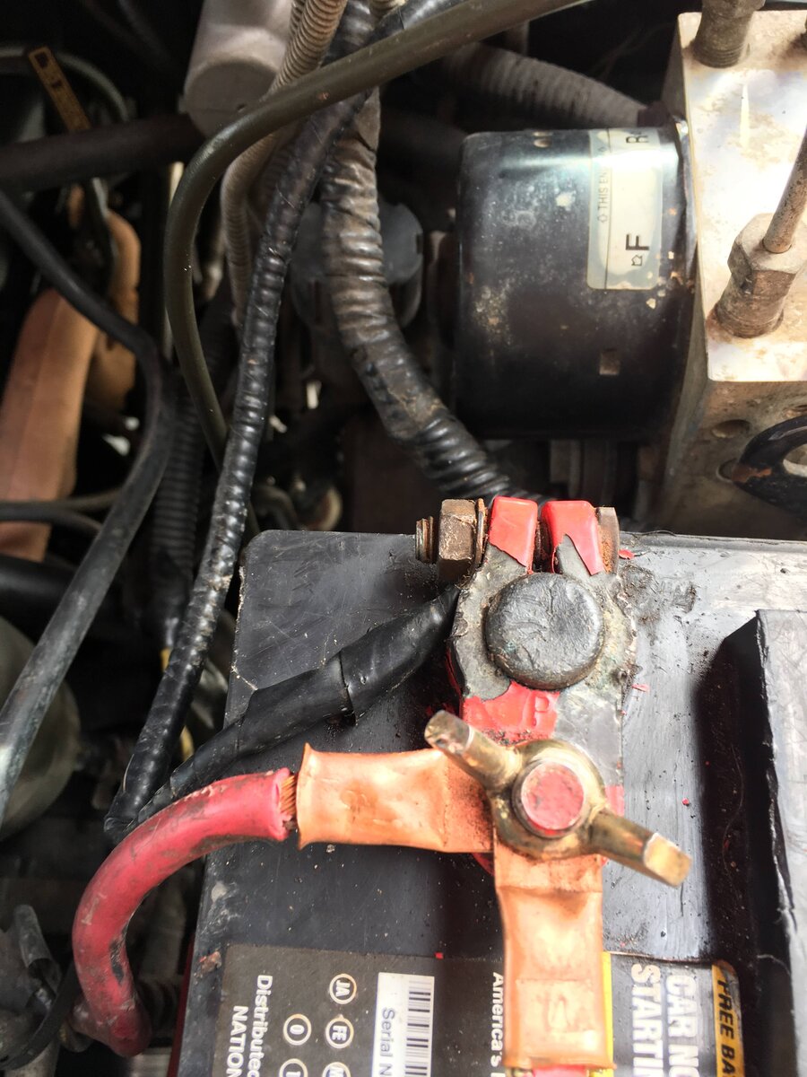

How many ground wires are coming off your battery? I see one going to the intake manifold (not good)
The intake is a steel bolt into aluminum lower intake, I do not think that is a good ground for the engine
(You need three good grounds, one to the body, one to the frame and one to the engine BLOCK the cast iron part)
Get rid of the wire nuts, fix the battery grounds
clear the code and lets see where we are at

I've got two grounds coming off the battery - one to that bolt on the intake, and a smaller one right next to the battery on the radiator support. Where would the third be? And where would be a better engine ground - is there a typical spot for that?
Also, three wires coming off the positive side. Just adding that info in case it comes up or looks suspect in any way.

that engine ground is not doing you ANY GOOD
the battery to engine ground should be down at the bottom of the timing cover there are two studs that face forward coming out of the bottom of the timing cover, one of those gets the battery ground
Also YOU NEED TO ADD ONE MORE BIG GROUND< FROM BATTERY TO VEHICLE FRAME
Your voltage and power issues might very well be bad battery wiring
Otherwise you will likely keep having all sorts of sensor voltage issues as the vehicle components search for a good ground..........
Also I do not like that aftermarket TPS and wire nuts! Wire nuts have no place under a hood, temporary or not!
3 grounds REQUIRED:
the one from battery to body looks ok
The one from battery to frame is MIA
the one from battery to engine is NO GOOD going to aluminum intake............because steel bolt is going through the upper intake into the lower intake and the lower intake is sitting on top of gaskets, this ground needs to go to engine BLOCK
Intakes make a POOR GROUND
3 grounds REQUIRED:
10-4. I'll get cracking on these items and let you know how it goes. :) I sure appreciate it!
