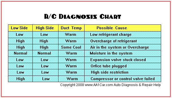

When the reading is between 25 and 40 psi with the A/C running, STOP. The system is fully charged and should be cooling normally
The HIGH side pressure is more difficult to measure, the recharge kits have only low side pressure gauge.
