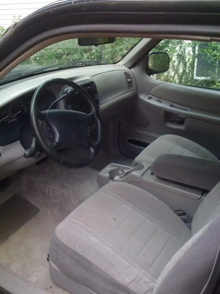

Here she is! I love it, I got a kick ass deal for $1300. Those brand new A/T tires sold me.

1300$? I hate lucky guy's :)
