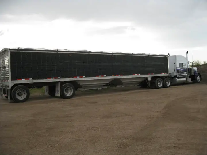

I don't do too much for downshifting in automatics. Heck, I got brakes and it'll shift itself. Admittedly, I still gear brake here and there. Sometimes I have jakes and more gears....say, 18...and I don't even need the brakes :D
