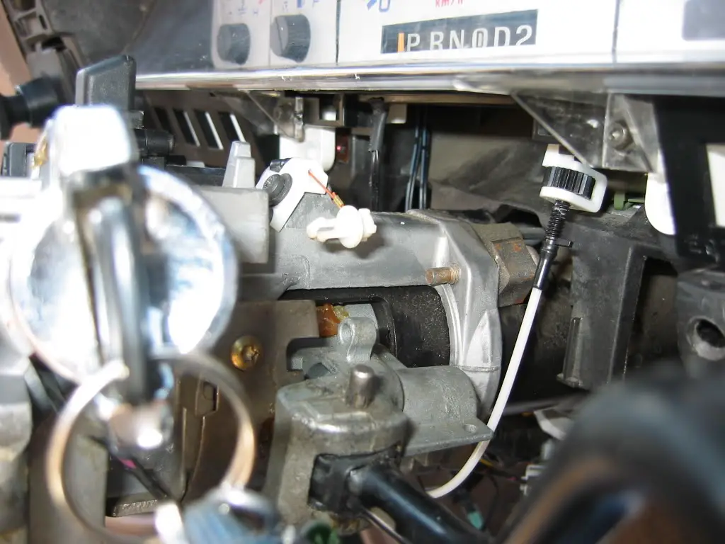

Hi and welcome, if i remember when I last had my dash apart, you can take it out of the cluster but it's a PITA

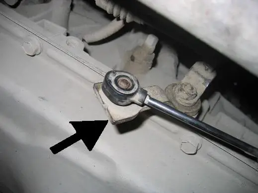

Here is the picture of the piece I am talking about.
To install the B&M shifter, I either need to make a custom gear changer piece, or make a custom piece to attach to my shifter cable and slide over and stay on the pin on the stock gear changer.

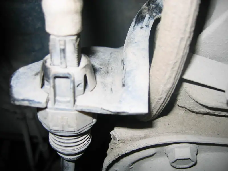

Another thing I would like to know is, how do you remove the cable from this bracket in the picture below.
Squeeze those two plastic ears with a pair of pliers then you can take that out of that notch in the bracket

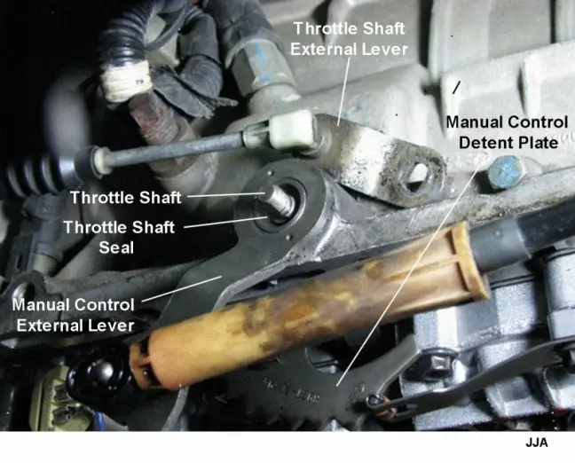

The manual control external lever in the photo below connects to the gear selector assy via the shifter cable assy (yellow tube).

This manual control external lever is a part of the shift shaft assy shown in the photo below.

You can see that the shift shaft assy goes into the innards of the 4ALD and parts must be removed to removed this assy.
The shift shaft assy can be removed as discussed in the following link and the reference links shown in this link.

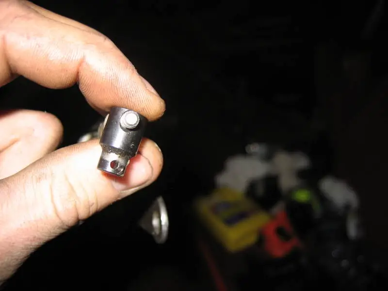

I got this shifter and cable out of a 86 Ranger with a 302 in it, that has since became a parts truck. The tranny on it had a manual lever on it that accepted the cable end pictured below. There is a hole in the lever that piece would go through, and had a cotter pin securing it there.

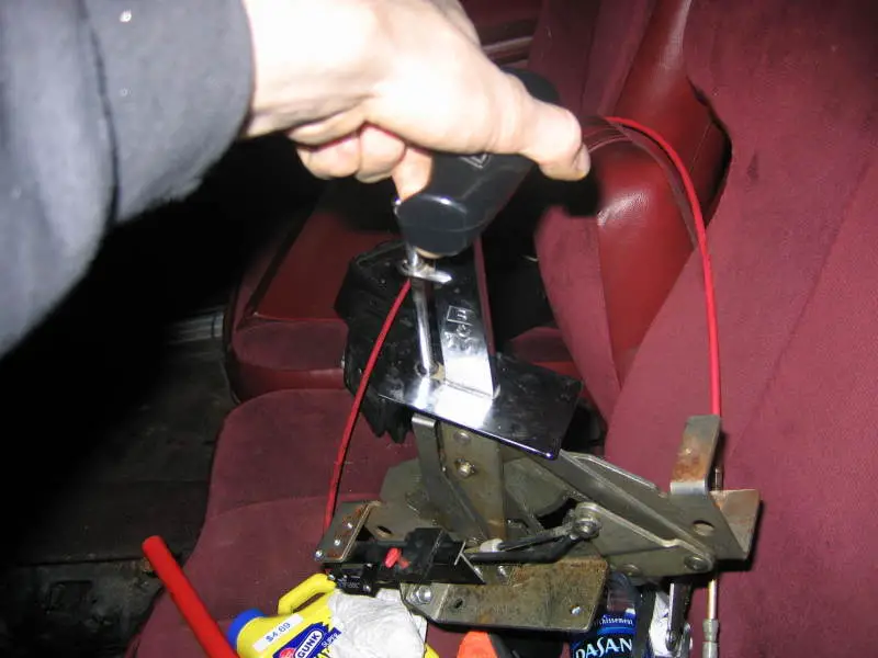

And below is a picture of the shifter itself, with out the boot on it.

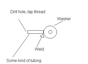

I made a sketch up of the shifter piece I could fab up. I havent thought of a way to secure it to the lever though.
