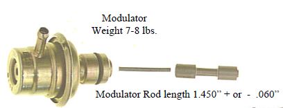

Did you install the pin from the old modulator?
Sometimes people dont know its there and it will be missed or it falls into the drain pan and gets lost.
Use a small nail or piece of coat hanger if you need to make one.
