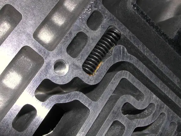

Before you reinstall the valve body, remember to clean out the spring in the underside of the transmission case. The spring acts as a filter. Here is a picture of it:
Ahh, yep, I was inspecting that after I removed the VB.. I'll make sure to remove, clean and reinstall before installing the VB..
