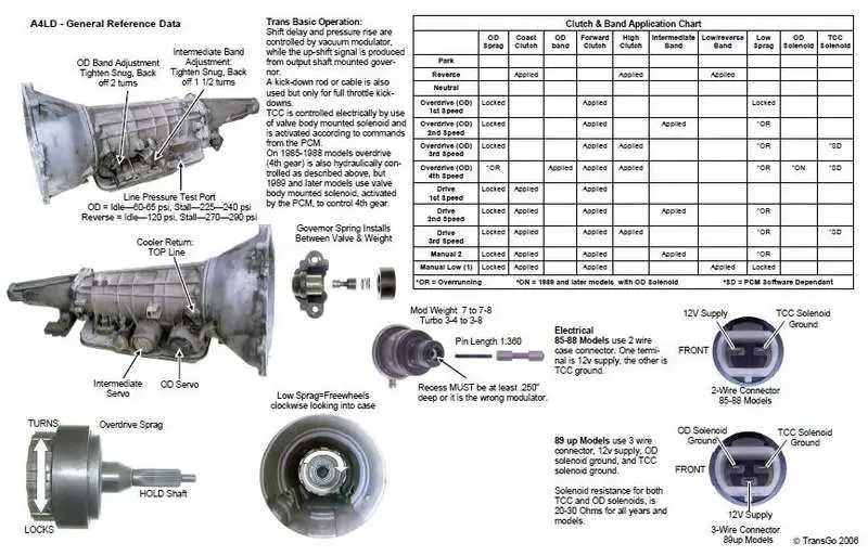

thanks I will get gage and check can I hook the gage to the outlet side of cooler
can you hook gage to inlet or out let side of cooler
You connect it to the pressure port on the trans.
IIRC its on the drivers side of the trans up and towards the front when compared to the shift linkage pivot on the side of the trans.
