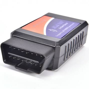

What is an elm327 adapter, what does it look like and where can I get one???

Is this it?

AWESOME!!! THAT WAS RIGHT NEXT TO THE ONE I JUST POSTED SO YOU CAN LOOK AT... LOL!!! Thank you Donald for all your input!!! I really appreciate it!! You're helping me keep money in my pocket that I don't need to spend thank you again.
