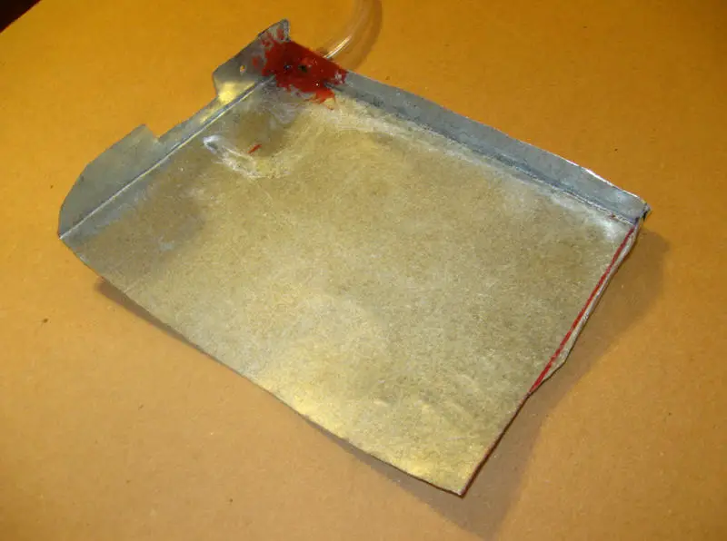

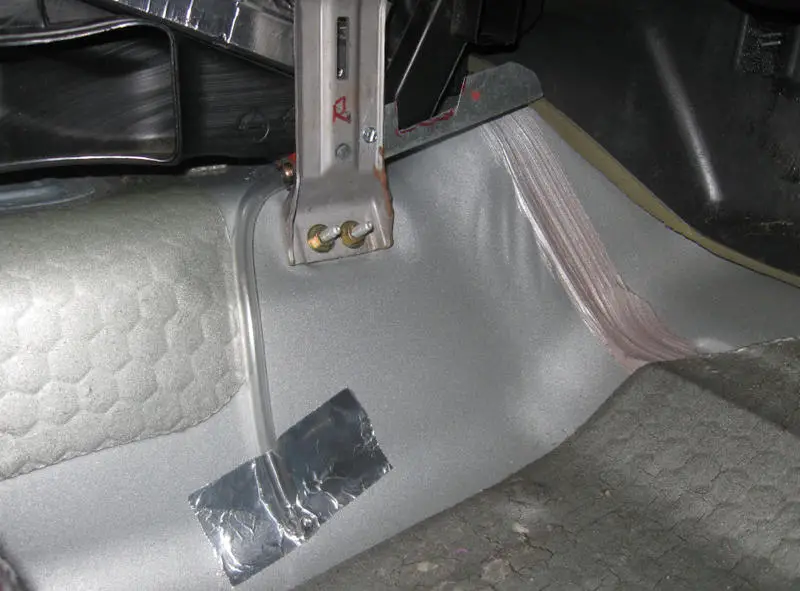

My solution
I never could find why it is dripping water on the right side of the AC/heater core; so, here is my "workaround solution" to eliminate wet carpet.
I made a secondary drip pan that slides underneath the drip and routes the water outside the vehicle.
I used a piece of dryer vent.
Cut out a section of 9"x8". Fold sides; trim as shown.
Don't make the cut on the right. Just leave it 1". I thought I would have to go under/around the vent; but didn't need it.
Drill hole for drain, attach hose connection.
I used caulk around connection so it doesn't leak
Attach hose.
Slide in under existing box up as high as you can go.
Drill hole in floor pan.
Route hose and secure to floor pan.
I attached a bottle for a few days to test it and I captured about 16oz. per day. All that was going into my carpet. Now drips on the ground.
Not pretty or elegant, but it works for me !
