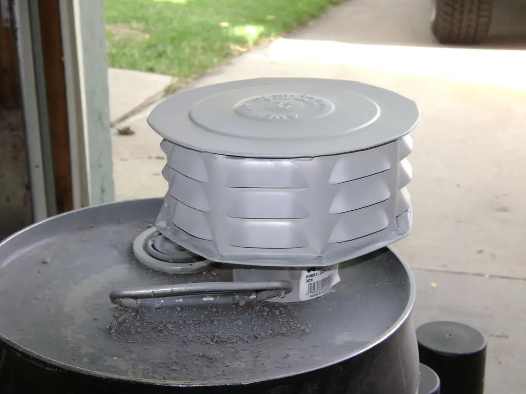

I got busy a week or so ago and added this to my X.........
Here it is all done and sealed up...........
For around 100 bucks I don't have to worry about hydrolocking an engine.....:thumbsup:

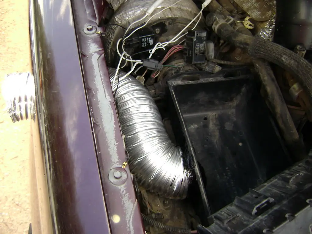

Heres the filter box set up.....
And with the fuse block in place.......
The hardest part was cutting the 3 1/2" hole in the fender.....

The top piece is from Home Depot not sure what you call it, I was wondering around and said to my self "hey that would work for my top".........

...the cap is called a "B" vent cap, used on water heater and gas fireplaces as a vent cap....:D
...just a heads up but the dryer vent piece coming from the stock box will be your weak link....:scratch:
Yes it is 3" PCV , 1 90 degree elbow and 1 45 degree. To make to bends between the airbox and inner fender, I had to use the dryer vent, but being under the fuse block it shouldn't get hit or abused to bad.

When I tried a flexible dryer vent between my MAF and TB it crushed!
I would recommend something more rigid on the your DIY CAI. I successfully used a gutter "Flex a Spout". The Suction caused by the engine under acceleration could be a problem.
