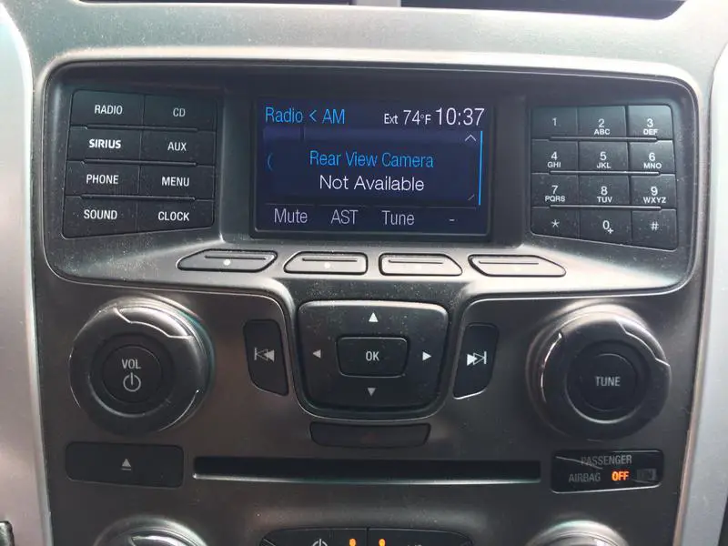

I know some MFT units and some that have the basic 4.2" display didn't come with back up cameras. I can enable the back up camera feature on the MFT system (you have to add a camera). I need to do this in person or you have to send me your APIM.
On the basic 4.2" screen I modify the vehicle programming which your dealer can load. I tested this on a 2014 PI Utility. It comes up with that error message as it isn't seeing a video input. Shows that it can be done though.
I am working on sourcing the parts needed to build interface cables that plug directly into the OEM connector for the APIM (MFT units) or the FCDIM (4.2" MyFord). You can install the OEM camera or use an aftermarket camera. This will give you basic back up camera functionality.
