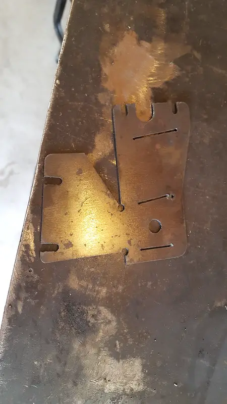

While searching on Amazon I found some $19 LED pod lights so I decided to give them a try. I needed mounts so I decided to try the bottom of the windshield/ Cowl area. I drew up a bracket and cut them out.

Not having a decent way to bend metal I resorted to a hammer and vice. The cut lines in the bracket help to line up the bend points.

Two brackets mirror images of each other for each side of the truck.

To mount them I just pulled the fenders off and ran some self taping screws into the body to hold them. If I plan on keeping them I plan on getting rivnuts to use.
For measurements no. If you would like a set send me a pm and I could make another set on my plasma table and mail them.
