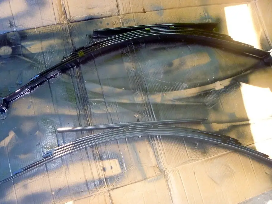

Since it only went for a five mile ride around town, and climbed one rock, I did not expect it to settle. It looks like it might have settled slightly, or maybe I just got used to it. This project is still in the experimental stages. This next Truckhaven trip will take care of any settling and show any problems with doing this.

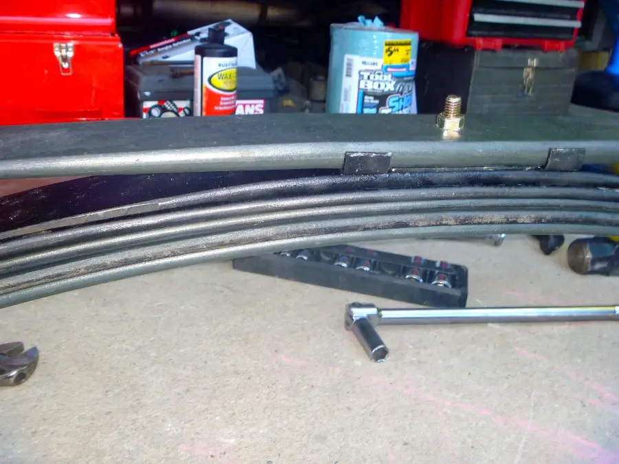

Started with the standard three leaf plus an overload spring Explorer pack. Took out the overload spring and added two more (cut down main and second leafs). If I get axle hop or spring wrap then I will take out the second leaf (cut-down main) and put the overload leaf back in, but upside-down.
How many leafs you decide on is up to you, what you plan on doing with the truck, and the ride height. Need to mess with it to see what works for you. I suggest you cut down the entire set of old leafs at once and mix and match until you get the right ride and ride height. Also remember a shortned leaf spring will be stiffer than the original. If you are towing or hauling loads with it, then you should leave the overload leaf in. I don't tow, and the only road miles my Explorer usually gets is flat towing it to the dirt, and maybe a ride around town to keep the battery charged up.
The cool part about this project is if it doesn't work, I am only out some old worn out cut-down leaf springs, about four hours of my time, and a few bucks in paint.
