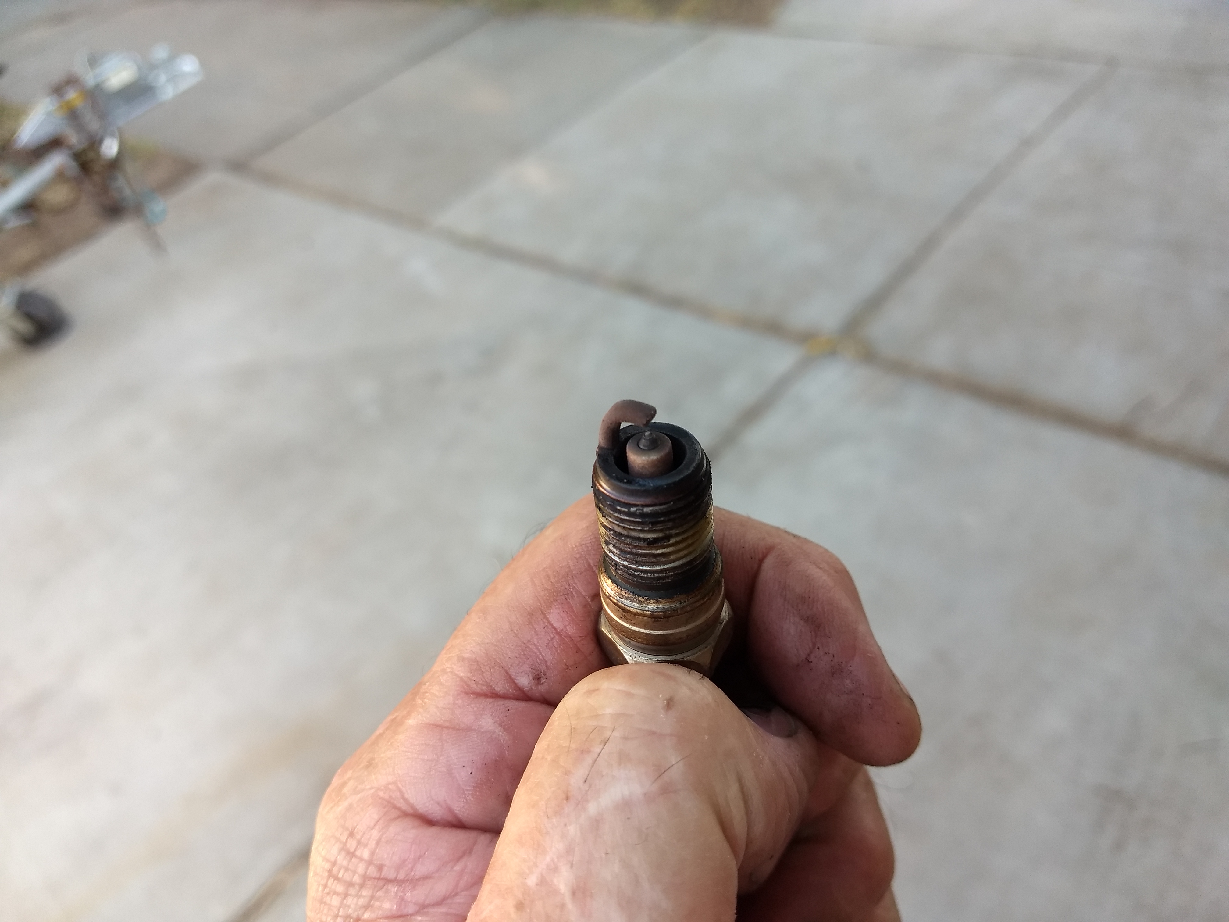

OK, my misfire has been solved. Turns out the plugs are all worn out,. No wire tips. I swapped in 2-4-6 but 1-3-5 will take some more work, I might try it this weekend from underside.
What I thought was an injector, or a head gasket or a head or intake, turned out to be worn out spark plugs.
