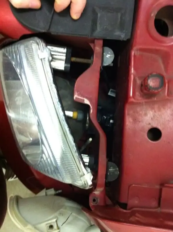

i am guessing that these are the twigs. But there are no nuts on them. The long one that is vertical doesn't have anything on it. and the other 2 just have plastic caps on them.
the long one has no nut or anything on it. on either side

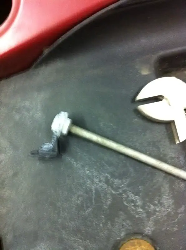

it was a 4mm. at it was so corroded that it just snapped off.
doesn't look like ill be getting them adjusted anything soon. I guess this was one truck that wasn't built for tough

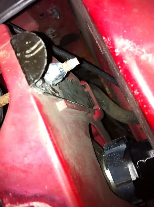

You'll need to take the assembly out of the grill. There are 2 pieces of metal you lift up and take out so you can take out the assembly to replace the headlights. See the owners manual. Unplug the headlight once you have the assembly out. The gear box that the adjusting rod was connected has a threaded rod extending out. You can spin the whole little box instead of having to turn the rod that broke. I had one light pointed almost strait down, my daughter hit a mailbox. I didn't want to brake the rod, and it wouldn't turn, so I spun it like a propeller 4 revolutions, and it's right at the same height as the drivers side now. Hope this helps someone.
