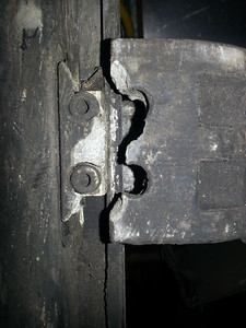

One of the mounting brackets for the right power running board on our 2007 Mountaineer broke.
The bracket is not available separately, the entire assembly is upwards of $1200, and I haven't found any used ones at a reasonable price. So I'm thinking about just replacing the power running boards with aftermarket fixed running boards.

I just went thru the same issue. I bought an 07 Eddie Bauer with power running boards. They were stuck in open position. I tried to fix them but they were beyond repair. I tried to mount them as fixed position closer to the body of the car since they are too low. I had to cut those hinge/brackets into pieces.
In the end, I bought a pair of almost perfect OEM running boards from a wrecked Eddie Bauer and just bolted them to the car in 30 minutes. They look great, paint is perfect. $ 150, can't beat that.

I might have that part you are looking for, let me post pictures maybe tomorrow of what I have.
The power boards are held in 2 spots per side, using 3 x 13 mm (socket size) bolts on each bracket. The fixed ones I bought are mounted in 3 points. I had some 8mm bolts, and I used them in the middle spot.
Yes, there are AC lines going on one side to the rear, so aftermarket brackets will interfere. I had to pray the lines a little to place the new bolts in the existing holes at the lip of the car body.
