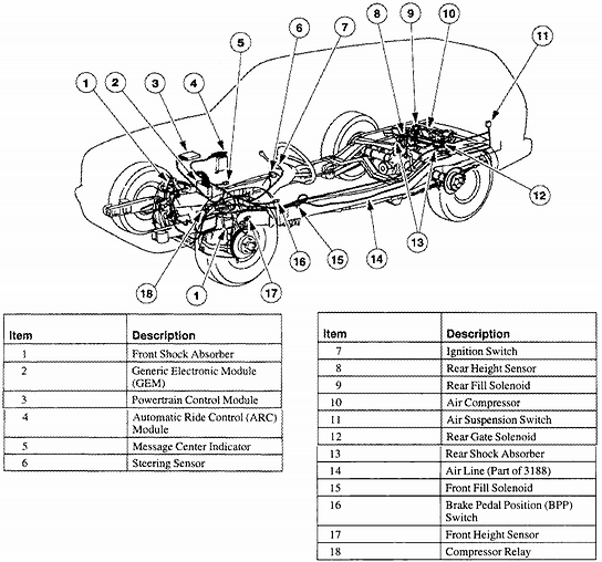

quick question, hopefully an easy answer. I have a 1999 Explorer V6 4l with air suspension on the rear and I have noticed that it doesn't appear to be working anymore as I can't hear anything happening. Could someone tell me where the pump is please so I can check it out, thanks.
Afaik. The pump switch should be located in your trunk, left side there should be panel, under it.
And for the pump location perhaps this helps:
If you do quick youtube search you will get some good guides for repairs.
Edit: it might be good idea to check the fuses too.
