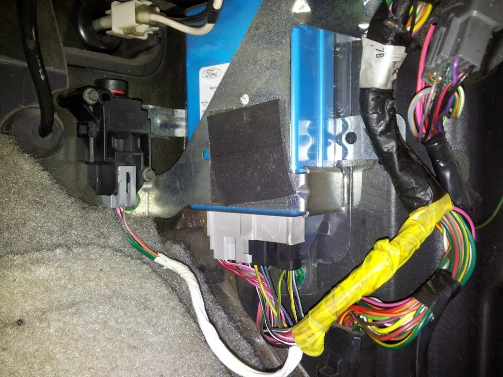

A few photos to show what I have.
The first is of the airbag Control module, located at the bottom of the A pillar passenger side, and as you see, no connectors or wires available.

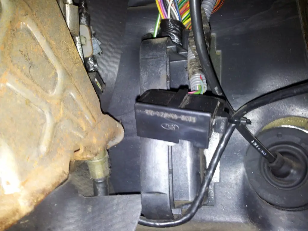

Second picture is from behind the glove compartment, this is a connecter that I believe is used to bypass the passenger airbag in case of use of child seat, can anyone confirm this ?
