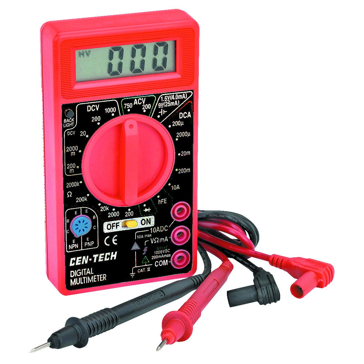

Unfortunately, I don't have an Ohmmeter. One of these days I'll get one.
Here's a cheap meter for $5 on sale: http://www.harborfreight.com/7-function-digital-multimeter-92020.html
It's hard to pass that up for only five dollars. Went ahead and ordered it. Shame that shipping is more expensive than the product itself. ha.
