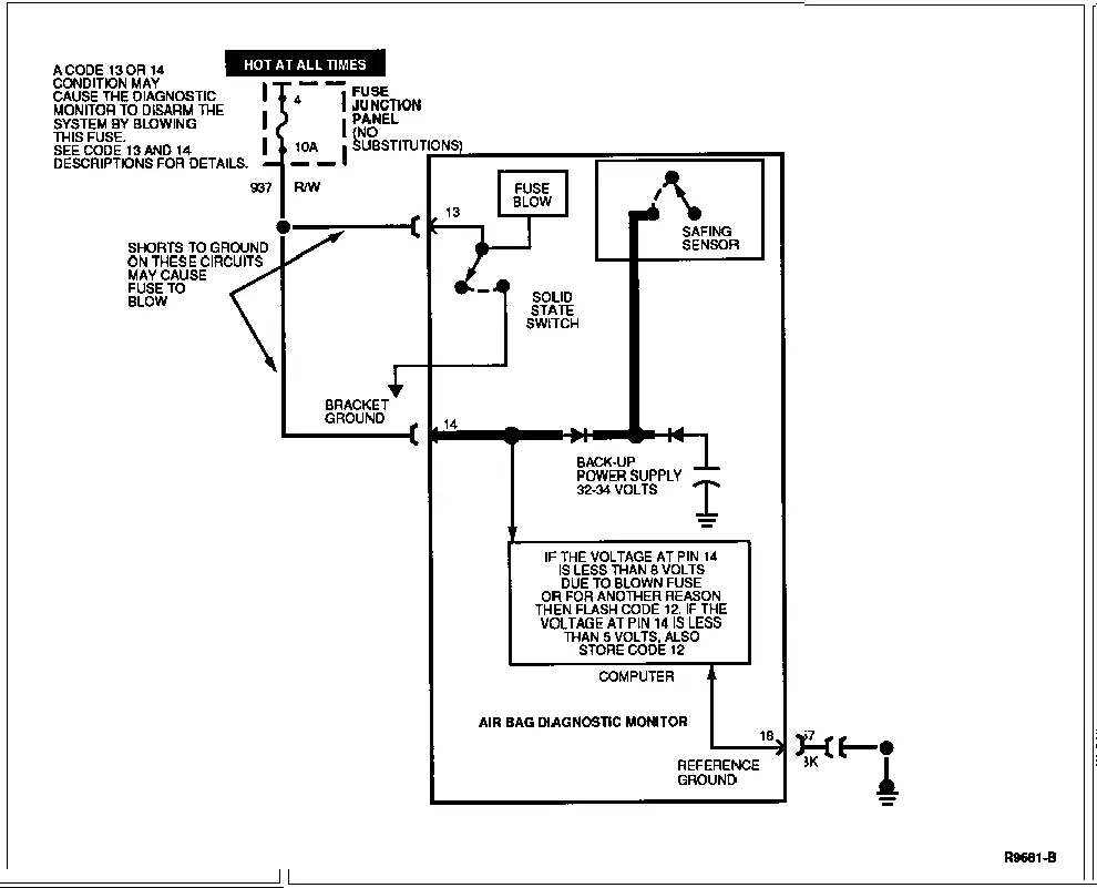

Here is a schematic for the Mustang:
I know that it's not for an explorer, but you will get an understanding of how it works.
