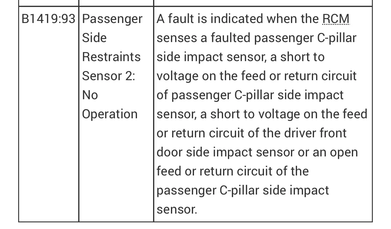

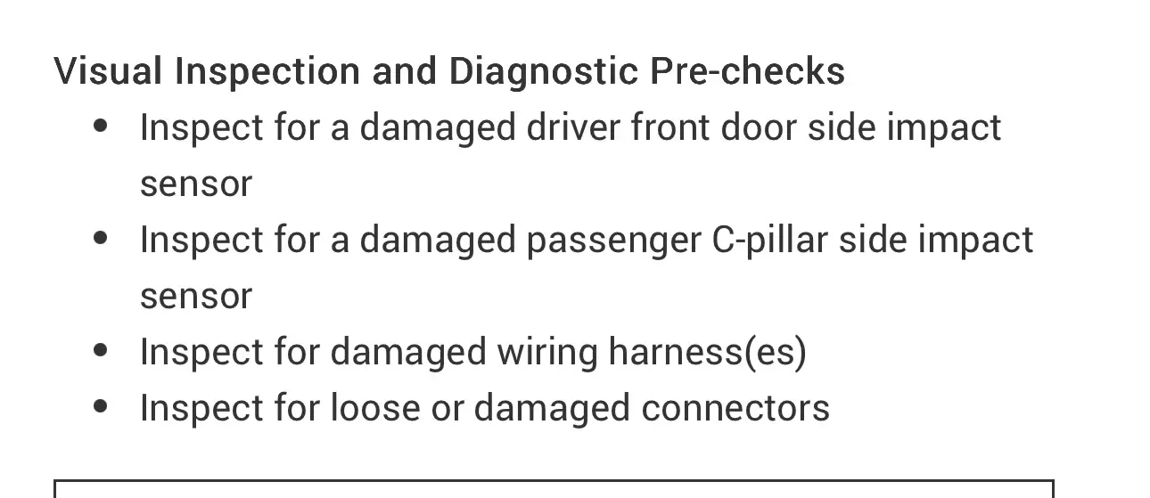

With out seeing the PIU in person I can’t tell you go check this or that, but this is the pinpoint test that Ford gives us. Maybe check these areas since you replaced the door seals and check for connector fitment.
Thanks for your response!
One thing I noticed in your message and on-line is that it says it the error code corresponds to Sensor 2 while FORScan says it is Sensor 3. Is it just a mistake in FORScan?

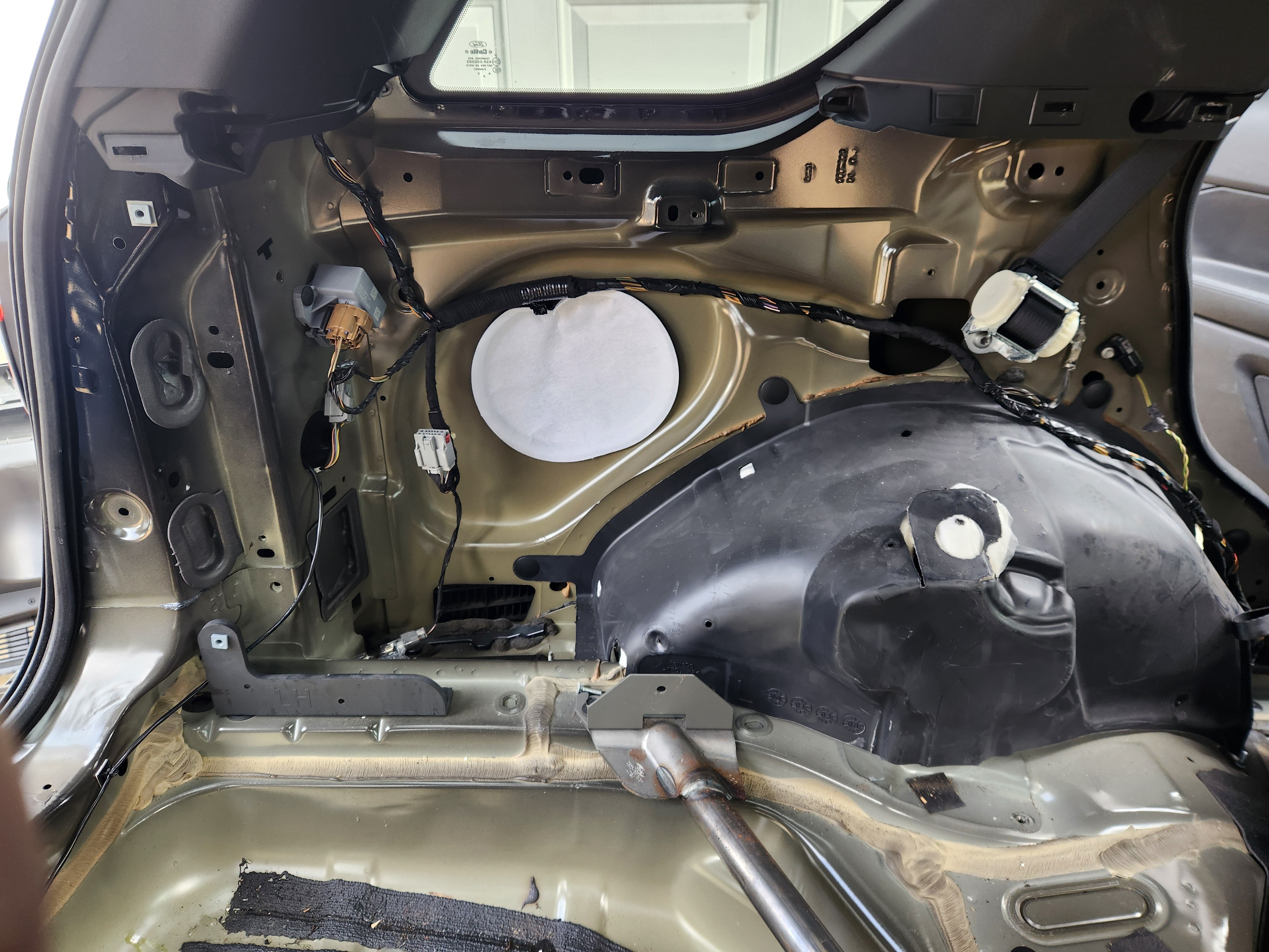

Loose harness retainers are irrelevant. Look at the integrity of each wire that serves the indicated component. In my '16 PIU, the cargo trim panel can be simply pulled out from the C-pillar (without any other disassembly) far enough to see the impact sensor which is around the height of the door latch forward of the shoulder belt reel, inches from the door opening. This shows the whole cargo panel removed, which is NOT necessary just to look at the sensor & its wires.

5) Always start with visual inspection.

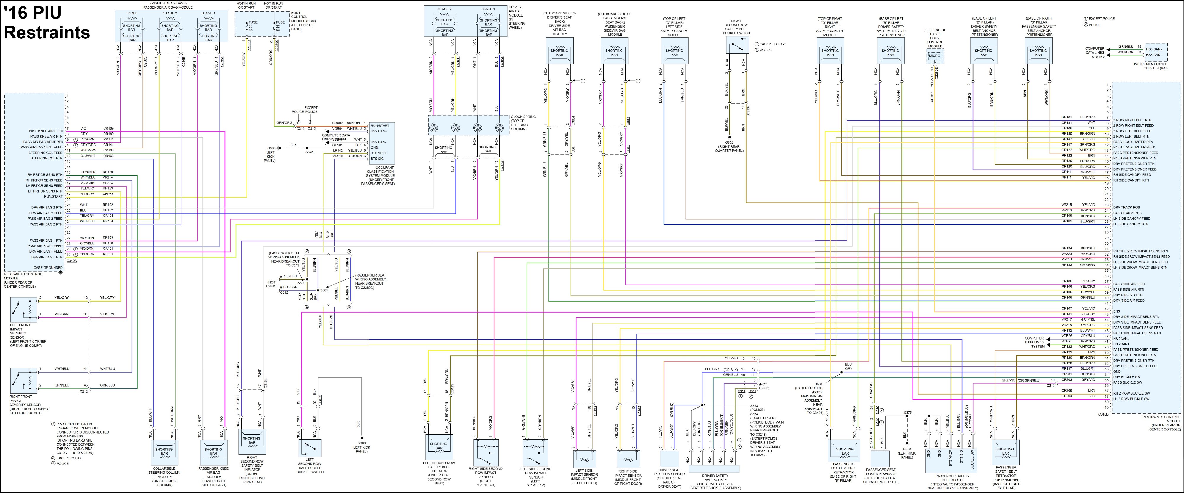

These show my '16 - yours is probably VERY similar.

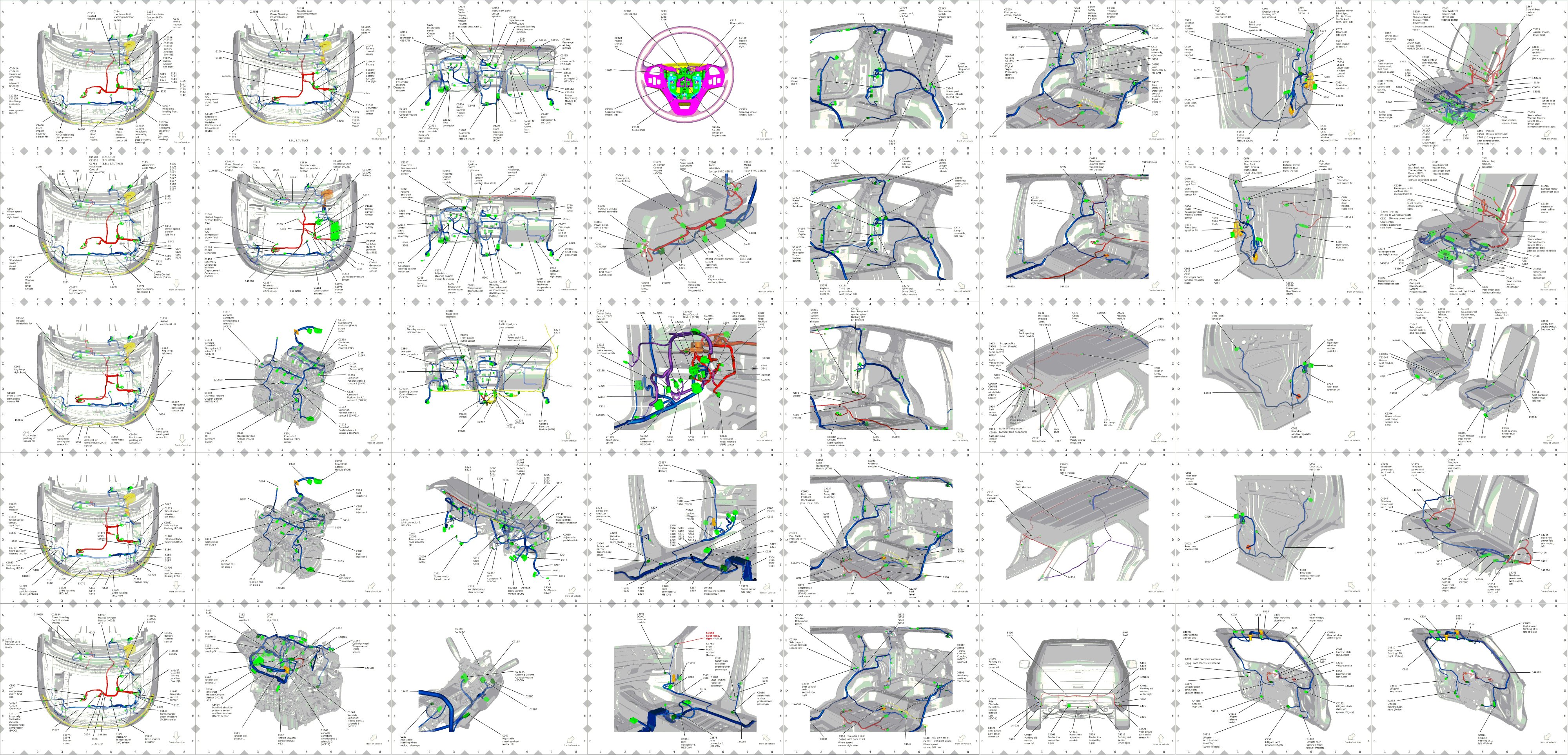

I added some diagrams above.

I think Forscan is wrong because the DTC B1419 with a 93 is from Ford.

The diagram shows the impact sensors
