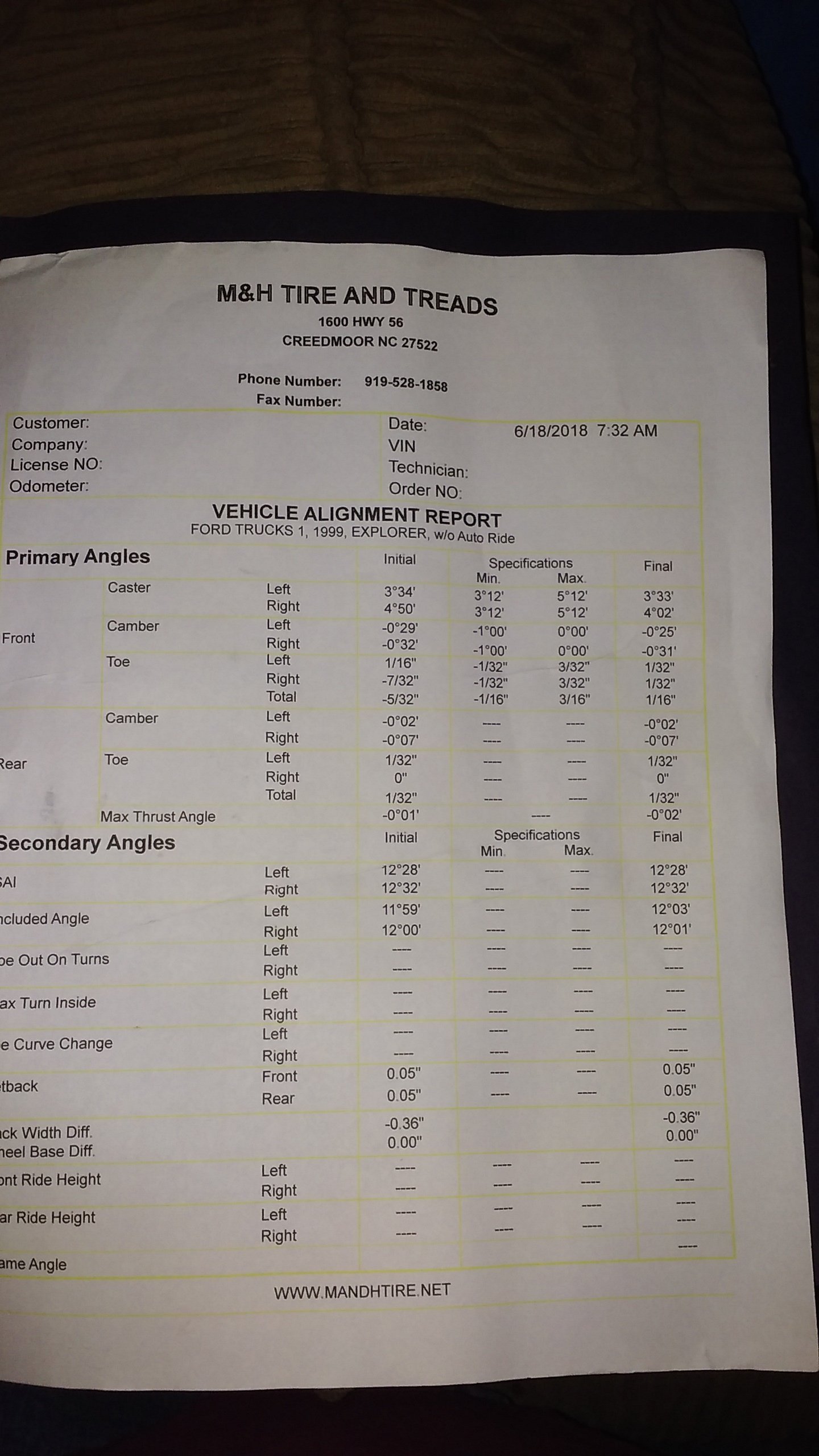

So I went to get a alignment today because I just rebuilt front end replaced both lower control arms both upper control arms both tie rod ends and some other things
I just don't understand the sheet to well I'm sure I can figure it out but I would like all yall
To chime in thanks in advance
Does it drive straight? Specs on the sheet look good. You need to look at the column's before and after to see what they adjusted and compare them to the "in spec" range.
Wife says it drives straight just wanted to be sure I have had problems with alignment shops saying it's on but it was not the first time at this shop
The tech said I got it close
That eased my mind
On the way home she let go of the wheel and drove straight thanks I can fix just about anything but alignments must be beyond me
Nevermind the colums boominXplorer mentions, you need to look at the top of the report.

A lot of the numbers on the report are more or less irrelevant or not specified, just because the Explorer doesn't have an independent wheel suspension but a live rear axle.
To understand what caster, camber, toe, and max thrust angle are really about one in fact needs to understand the definitions and the effects these values have on a cars performance. There is sadly no easy way around that really. And there is no really simple or easy way to explain them aside from a pictures showing them, which I sadly somehow can't seem to be able to link here.
And of course it's necessary to understand what effects each of these values have on a cars performance such as they are explained here for example:
Wheel Alignment Glossary
(This website shows a picture if you click on the link in the description.)
There are people who study at university for years to fully understand what all these alignments do, how to best set up a car, and how all the various types of suspensions work. And not all to few of those that do still don't end up fully understanding them non the less. Car suspensions are half science, half art, and half mystery.
As boominXplorer said the report lists all the measurements, the relevant specifications with maximum and minimum values for your specific vehicle, and the final results after adjustments.

As many parts of a stock OE suspension have rubber (or rubber-like) bushings there is no way to set and maintain a perfect wheel alignment under all conditions. Wheel alignment shops use OE alignment specifications to set wheel alignment w/in factory specs. Sometime this can be done by moving the upper control arms around and sometimes caster/camber bolt kits are required to get additional adjust-ability.
Performance and race vehicles use much firmer suspension bushings to limit movement/deflection of the suspension components at the cost of a much stiffer ride. Race vehicles also use very different components and alignment specifications to improve handling under race conditions.
Unless all the suspension components in your 20 year old vehicle have been replaced, even setting your alignment w/in factory spec on a static wheel alignment machine doesn't guaranty you will now have good alignment.

@donalds - Please don't refrain from posting your questions or comments on the forum. Some people tend to bore down into unimportant details. I don't think they meant to offend you and he did apologize for not knowing of your personal medical issues. I've been impressed by your automotive knowledge and your attention to detail when making repairs. Your presence on the forum is welcome IMO.
Thanks koda that's why a asked because I replaced all bushings both upper control arms Inc bushings

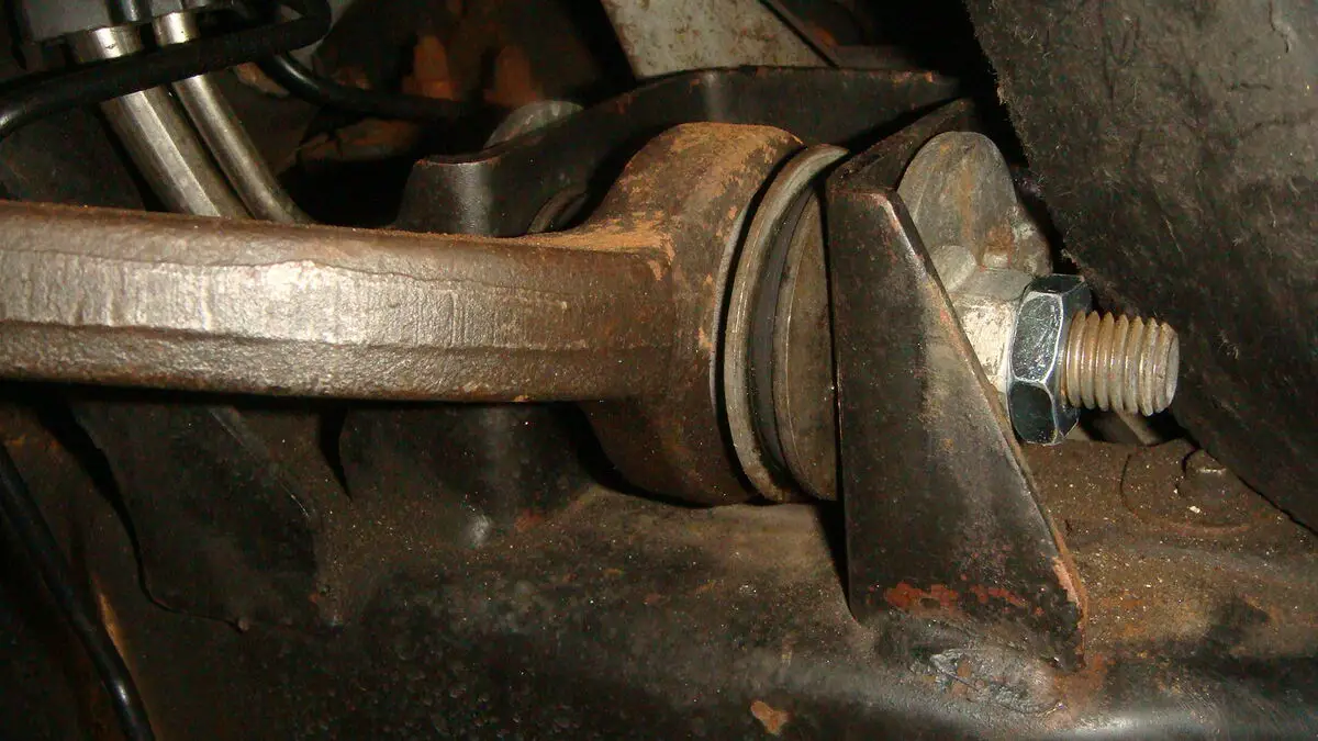

koda2000 (Phil) as well as I had issues with the upper control arm nuts coming loose probably from being improperly torqued. IIRC, spec on the UCA camber bolts is around 100 ft/lbs. with the suspension loaded and tires on the ground. Phil suggested applying green penetrating Loctite thread lock compound to the exposed threads. I went one step further and used four M14x1.50 jam nuts found at my local hardware store. If you have aftermarket camber kits installed they are even more likely to loosen than the non adjustable OE hardware. Camber and caster is adjusted my turning the bolt heads so it's very important they are not moved. Peace of mind knowing you won't need another alignment due to the nuts coming loose.
Thanks that's what the tech said non adjustable
Lol I was worried that the liberal amounts of blue lock tight I put on was gonna hinder the tech loosening them to adjust but he said non adjustable so when I torqued them that was the last time they were touched
I wonder why the cam bolt is not adjustable
Why put it there in the first place
BTW @swshawaii (Steve) - After the alignment fiasco on my daughter's RWD '00 Mountaineer a few months ago I put the new tires on the front and have been keeping an eye on the steering wheel to make sure it doesn't indicate that anything has moved again. The other day I examined the front tires and found the passenger side seems to be wearing normally, but the driver's side is wearing a bit more on the inside edge than the outside edge. I know that my wheel alignment guy tightened the crap out of the upper control arm bolts and I don't recall off hand which side had the adjustable caster/camber kit on it, besides who knows what my daughter might have run over? I might take it back to my alignment guy just to have him check the alignment, but I'm really getting tired of screwing around with that truck. My daughter doesn't put many miles on her truck and we plan on replacing it soon. In the meantime I'll just keep rotating the tires frequently.
