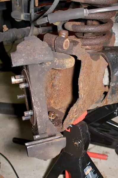

Sounds like you have too much positive camber. There is an adjustment nut on the top of the ball joint. Loosen the pinch bolt and turn the adjuster. You can onlt guess the correct angle to get it close. I would take it to a shop though to have it done right. An alignment should only cost $35-65. This pic might help some.
