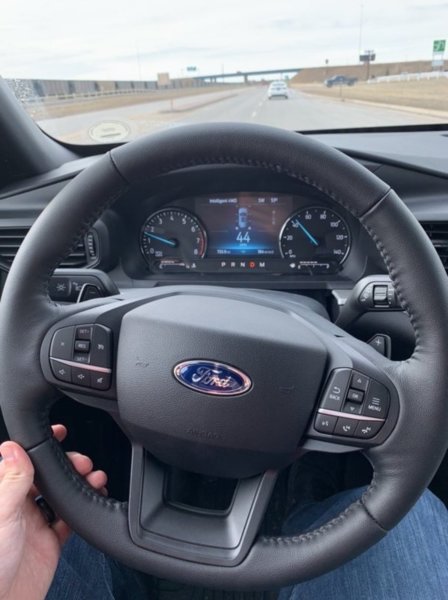

So my 2020 pulled to the left from the day I left from the day I got it. Finally got it in to the dealer, and they got everything aligned properly. They told me the toe was off. But now the wheel is a solid 3 degrees ****ed to the right. Drives straight as an arrow now with no hands on the wheel. They’re not sure what to do to fix it other than pull the steering wheel and trying to reattach it. Attached is a picture of how bad it is. Anyone else with issues with this?

Have them do the alignment again. They set the toe with the steering wheel off center. It is a very simple fix.

Pawning off an alignment because the parameters are in the "green" is poor workmanship. If the shop can't center the wheel during an alignment, that is a poor technician. A competent alignment guy can center the wheel easily. I would take it to another dealership and leave poor reviews with Ford for your current dealership.

Do you have a good suspension / alignment shop near you? That dealer doesn't seem to understand the basics of wheel alignment. As the previous reply said, they adjusted the toe settings with the wheel ****eyed. Of course it never should have left the factory that way, and if they can't get it right perhaps there is something else messed up with the suspension.
They need to center the steering wheel. Then they need to put the steering straight and use the steering wheel bracket that hold the steering wheel. it's a tool that looks like a Y with two hooks. Then is when they can do the alignment an it will be on center. I had a 2017 Platnium and they had to do the alignment and it was dead center..... That dealership has bad tech.

With electronic steering, some modern vehicles can actually command a center position in a service mode, for purposes of an alignment and a perfectly centered steering wheel. I don't know if the Explorers have this service capability, but either way a tech should be able to successfully align your steering wheel. Truth be told, I have done home alignments for about 15 years now and can center my steering wheel perfectly with some basic measuring tools in my garage. A dealership tech that can't do this should sort of be embarrassed.
I am an alignment tech at my work, one thing that every tech should know is green does not mean good. Parameters can be green but cause pulls, i have seen it myself. And something as simple as adjusting toe to center the steering wheel is super easy, sounds like they have a load of dumbasses working there.
DO NOT let them pull your steering wheel and attempt to recenter it, that is the WORST idea I have ever heard. I would take it somewhere else for sure
