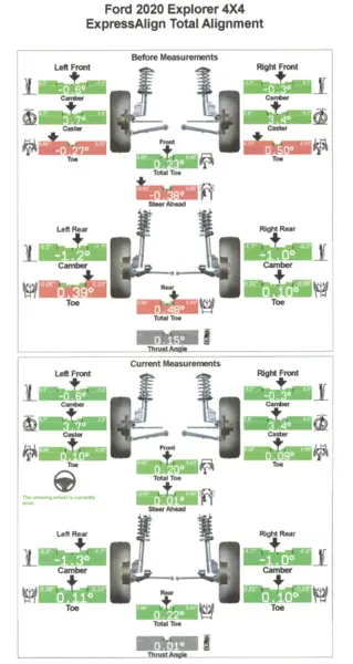

Well, third time they had it. This is the alignment chart from their service. Apparently, their second alignment was so ridiculously out of spec that it caused this. I swear, if I had another dealer even reasonably close, I would never EVER return here. It does drive / the wheel is somewhat straight-ish now. Not perfect, but I'll be damned if they try adjusting it again...

Wow, thats no good :laugh: honestly its not too far out tho, just looks like someone was lazy. The rear toe was probably never adjusted, which it should have been. And your front toe is perfect which you can tell from the total toe measurement, minus the steering wheel not being straight which can be seen at the steer ahead measurement. Looks like its adjusted pretty much perfect now.
